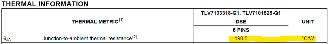

     At what ambient temperature are you planning to run this device at?   At room ambient temperature (20-25C), your setup is fine. However, you need to consider the thermal aspect if you plan to run the device at higher ambient temperatures.
    The device is spec'd at Tj=-40C to 125C.
    To calculate the max ambient temperature (Ta_max)  where this device can be safely run, with your conditions above, without violating the specs:
    Tj_max = Rthetaja x Pd + Ta_max   (see below table for Rthetaja for this device)
    1V8 max power dissipation approx (Pd) = (Vin-Vout)*Iout = (3.3-1.8)*0.2 = 0.3W
     2V8 max power dissipation approx (Pd) = (Vin-Vout)*Iout = (3.3-2.8)*0.2 = 0.1W
    Total Pd = 0.3+0.1 = 0.4W
    Ta_max = Tj_max - (Rtherja x Pd) = 125C - (0.4W x 190.5C/W)
    Ta_max = 125C - 76.2C = 48.8C
