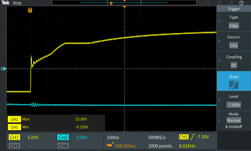

I use the UCC21520 to drive an IGBT which has 4.4nF input capacitance, 10 Ohm Integrated Gate resistor.
I used 7.5 to 10 ohm serial reistor to directly drive the IGBT gate. I observe that only when I use 0R (ZERO!) resistor, I get satisfying Switch- ON waveform (20nSec). The turn off waveform is also improved at 0 Ohm resistor (5nSec).
The resistor slows down switch ON time to 100nS or more.  I ask whether a 0R resistor is still a correct design, without over-stressing the UCC21520.

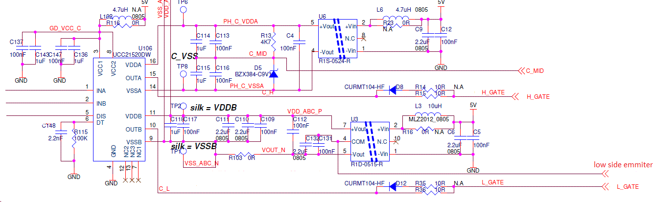

    Can you share more about your design, perhaps design schematics? The VDDA-VSSA voltage sounds fine +16V to -9V (25V). However, the VDDB-VSSB voltage needs to be changed. The +16V to -16V bias is 32V from VDDB-VSSB. This is larger than the abs. max rating in the datasheet and is likely to cause damage to the driver which could cause larger amounts of damage in the system. I recommend changing your CHB negative bias to -9V, to match the CHA supply. How is this supply generated?

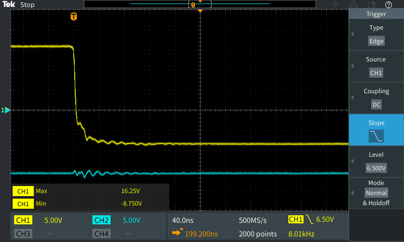

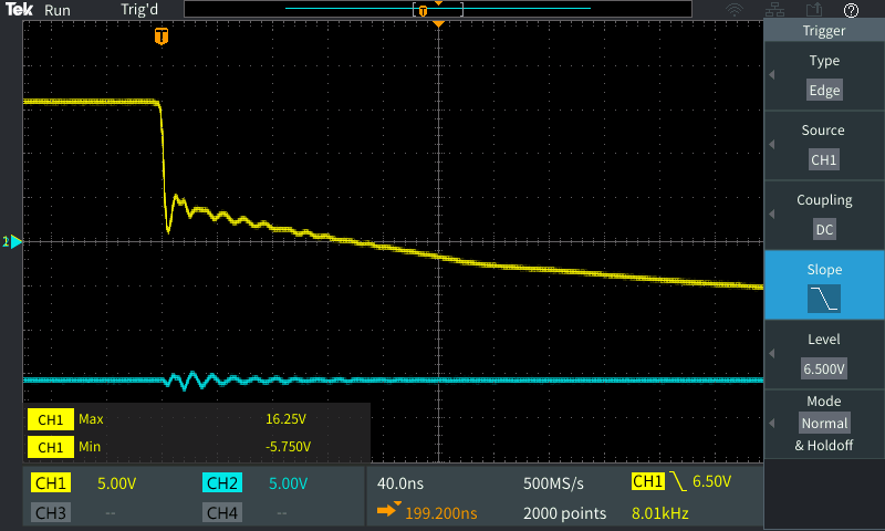

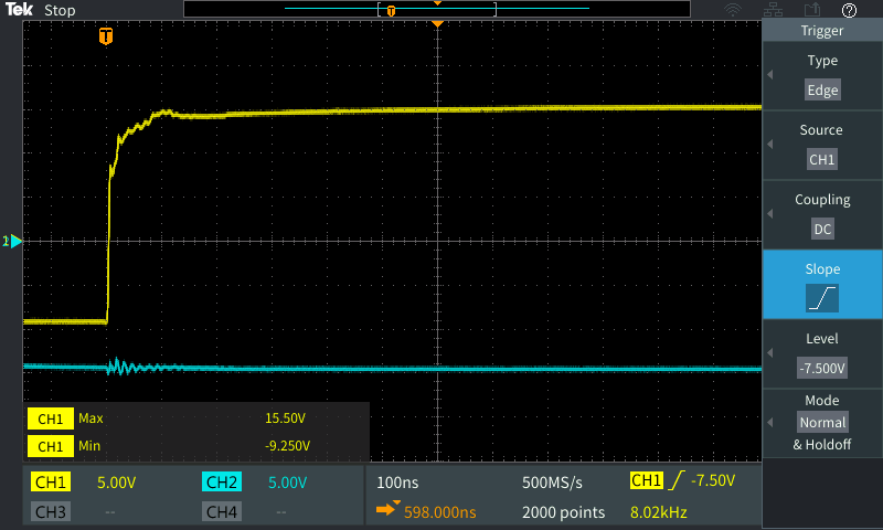

    I referred to the timings of the Gate to Emitter pulse.
    IGBT's Gate emitter threshold voltage is around 6v
    Please see switching ON and then OFF, looking at the Vgs, WITH 10 Ohm resistor, and WITHOUT it: (scale: 5v and  40 or 100nSec per grid)
    My switching frquency is 8KHz.
    I am enclosing my schematics here as well. True, my CHB VDD-VSS is 32v and I will change that. My current dual output power supply of +\- 15v (See enclosed file. not regulated Recom's 1Watt module) may be replaced to +\- 12v, so it should be ok . It will NOT be same as for CHA though. Do you see any problem with that?
    Another solution that I can easily make on my PCB, is to still use the +\- 15v dual output power supply, BUT adding a 5 to 8 volt LDO on the lower rail. This way I can get +16v and -9v as well. What is your opinion?

    Typically, gate resistors are sized to limit high frequency ringing on the gates. The rise and fall time of the collector-to-emitter waveform is not entirely dependent on the speed of the gate-to-emitter waveform. I might recommend keeping some gate resistance, at least for the turn-on path. Can you share your IGBT part number, so I can take a quick look at it?
    Your proposed solution of using an LDO after the power supply is acceptable for dropping this VDD-VSS voltage. +16V and -9V should be good, as long as they don’t vary too much and violate the abs. max.

    Which channel was damaged? Was it the one that still has 32V from VDD-VSS? If it still has this voltage, the damage is to be expected, since the output stage only has 30V FETs internally. You will need to reduce the VDD-VSS voltage and replace the part before doing any more testing.
    The driver should not be damaged by a large peak current alone. The output structure limits the output current based on the saturation characteristics of the internal FETs, and should not be damaged as long as they are driving capacitive loads and stay within the power dissipation limits of the device.

    I wanted to point again to the fact that with a 10R resistor, the Switch ON took approx 140nS to reach the threshold switching voltage, and much more time to completely get the IGBT into saturation...

    My concern about the slow "openning" of the IGBT, is not related to the overall time of the cycle.
    I am more concerned about the duation when the IGBT is "semi open". I am affraid tha the energy wasted on the transition time, between cut-off and saturation state, causes the IGBT to heat up. What do you say?
