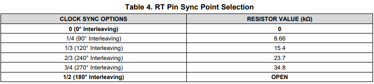

If the slaves are set to 90 degrees, 180 degrees, 270 degrees, then direct SYNC, VSHARE and ISHARE between master and slaves.
can work with stack 4x?

Jing,
TPS543C20 is 2X stackable only. You can adjust the phase interleave for the case where there is an external clock.
OK I'll bite - Why would they have all the interleaves available for 1X 2X 3X and 4X stack and you say its a max of 2X stacks?
James,
Depending on the converter duty cyles including other converters on the same input voltage, it may be advantageous to operate at other than 180 degree interleaving.
The reason you stack them is to increase the output current. They all have the same output voltage and duty cycle. Are you telling me you cant have one master and 3 slaves and drive them all with the master Vshare and Ishare and adjust each interleave for 90 degree separation and have a nice 4 phase 160A power supply? If you can't do 4 I see no reason you can even do 2.

James,
Phase interleaving is used to reduce imposed ripple on the input voltage rail. In many applications there are multiple output voltages derived from a common input. For just two TPS543C20 stacked, the 180 degree interleave is the logical choice suppose you have a third (different voltage output) synchronized to the same external clock. Then 120 degree or 240 degree may be a better option. In any case, TPS543B20 is only 2X stackable.

Check out the TPS546D24 chip. This is a 40A 4X stackable chip but we are going to see if TI has a better data sheet for it!
JMarr
James,
TPS546D24 will not be widely released. The replacement TPS546D24A will release in possibly in December.
