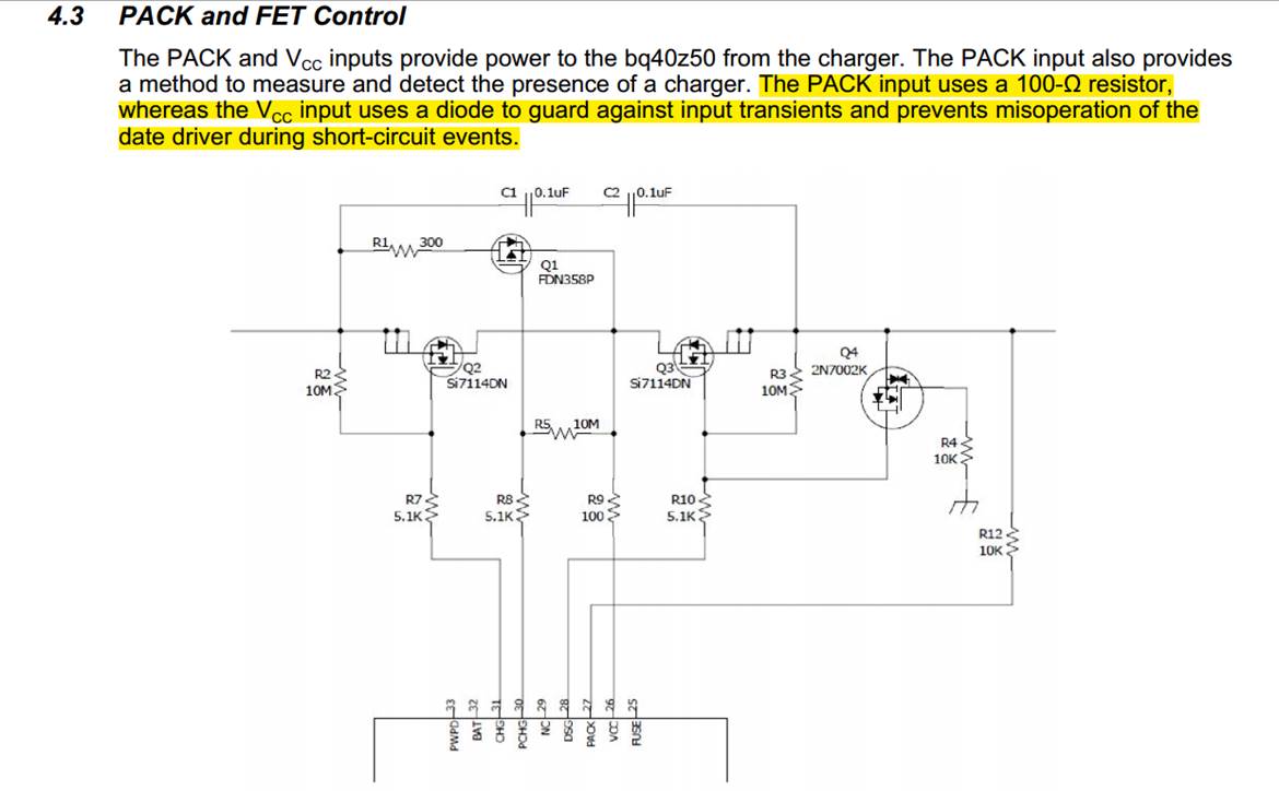

My customer checked BQ40Z50 application note SLU660A(bq40z50 advanced gas guage circuit design)and found that there is no 100ohm resistor connected with PACK pin, no diodes on Vcc pin as below description, can you please help double check? Thanks.
