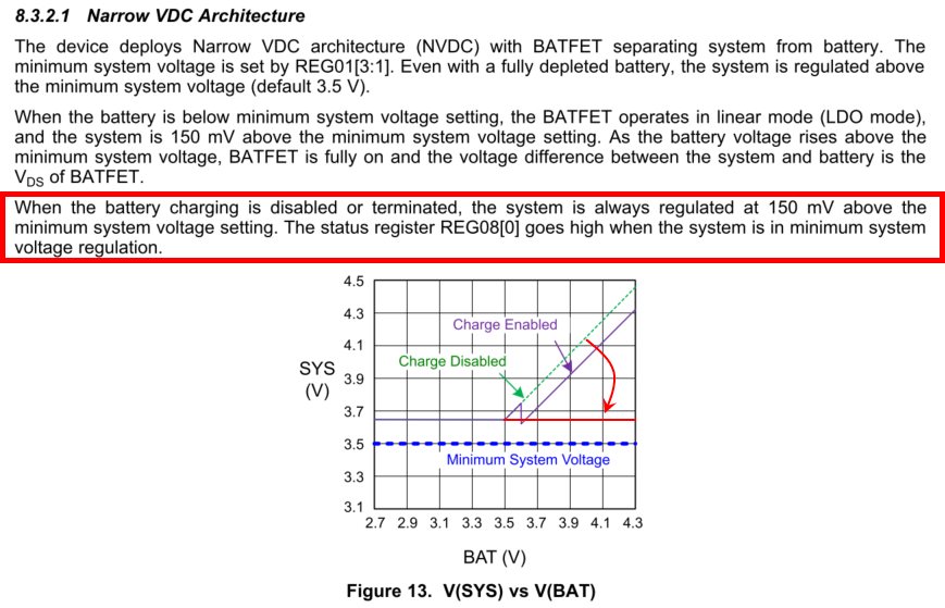

Hi Team,
Customer is looking for BQ24295 datasheet as below picture, the text shows Vsys is 150mV above "minimum system voltage setting". But at the figure, it shows Vsys is 150mV above "Vbat".
Would you please comment which is correct?
BR,
SHH
