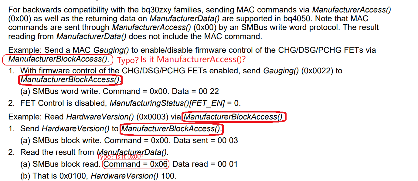

I have two questions about the TRM of BQ4050 in page 69.
1. Are these typos? I guess we are describing ManufacturerAccess()(0X00) in this paragraph.
2. In the example above, by writing, data sent=00 03 is not in Little Endian. But data read=00 01, is it correct?
In conclusion, my understanding is:
By using ManufacturerBlockAccess(), the command is 0x44, data sent and read are all in Little Endian,
By using ManufacturerAccess(), the command is 0x00, data sent are not in Little Endian, and data read are in Little Endian.
Is it correct?

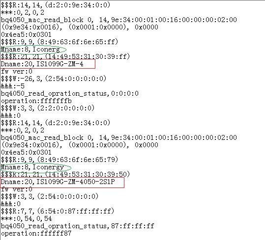

  • And my customer read DeviceName, LifetimeDataBlock with ManufacturerBlockAccess().
    But the result is not stable, sometimes the result is correct, but sometimes the result is partial correct, with FFFF in the later part of the data read back.
    What's the correct code to read this data?
  • Hi Howard,
    Yes, that looks to be a typo.
    Please disable the scanning when reading the data. Scanning will affect data read with manufacturerblockaccess.

    The customer's code reading device name and manufacturer name is shown below:

    Below is the result: we can see that the result we get are different between two times read.
  • Hi Howard,
    I was talking about the customer using bqstudio. In that you have the option of scanning registers from the register tab while communicating with the gauge on the advanced comm tab. Any scan of the registers will change data in the manufacturer access registers, therefore overwriting commands from the advanced comm tab. That's what I meant.
    Please do not overload the i2c bus with comms. You can read it at 1Hz. That's one way to avoid comm errors.
  • The IIC frequency is 33kHz and the reading interval is already longer than 1seconds.
    When they read data like voltage/temperature, the result is always correct.
    But when they read DeviceName/ManufacturerName, the result is unstable.
  • I have tried this with bqstudio and I haven't been able to reproduce the failure. The results here are always consistent. If they are reading other registers on the i2c bus and then reading manufacturer access the last command will overwrite the register.
