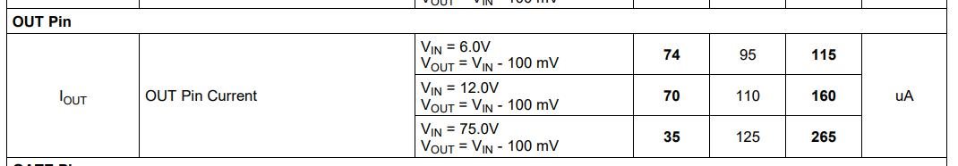

Is IOUT(OUT pin current) affected on VIN- VOUT?
I would like to know if IOUT when VOUT>VIN is applied following specification approximately.

Hello Kuramochi,
OUT pin current is not expected to change when VOUT > VIN, typical value will still be close the ones mentioned above (in datasheet).
For example with VOUT at 6V and VIN < 6V, it will be 95uA typical or close to it.
VOUT at 75V and Vin at <75V, it will be 125uA typical or close to it.
