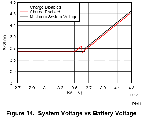

    By "switch-off threshold," are you referring to the maximum charge voltage at which the BQ25606 will stop charging the battery? If so, then yes, this regulation voltage (VREG) can be set to either 4.2 V, 4.35 V, or 4.4 V using the VSET pin.
    By "switching point of Q4," are you referring to the voltage at which the BATFET transitions from LDO mode to fully on, as shown in Figure 14 below? We call this threshold SYS_MIN, but there is no way to adjust SYS_MIN on the BQ25606. However, the host-controlled BQ25601 does have a register which allows you to set SYS_MIN between 2.6 V and 3.7 V.
