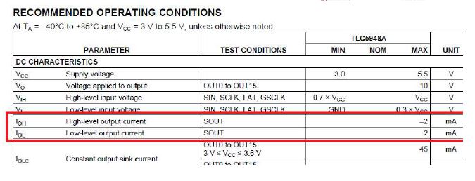

Our customer would like to know the absolute maximum rating of output current of SOUT in TLC5948A.
When the data sheet was confirmed, its absolute maximum rating is not described, and only the max and min values in the following Recomended Operating Condition are described.
Please let me know what value the absolute maximum rating will be.
