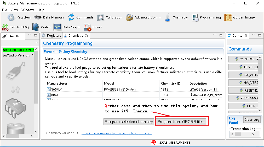

CCS/BQ34Z100-G1: bqstudio 1.3.86 --chemistry ID
Part Number: BQ34Z100-G1
Other Parts Discussed in Thread: GPCRB
hello, I have a problem that is marked in the picture about right button (progrm the file received from ‘GPC optimize room and low temp performance’ process),Question:What case and when to use this option,and how to use? Thanks very much!
    This is for when you do temperature optimization using the gpcrb tool. That will output a file that changes the characteristic curves for the chem ID stored in the device. It is normally used when you are mostly using the gauge at low temp and you perform characterization with the gpcrb tool.
