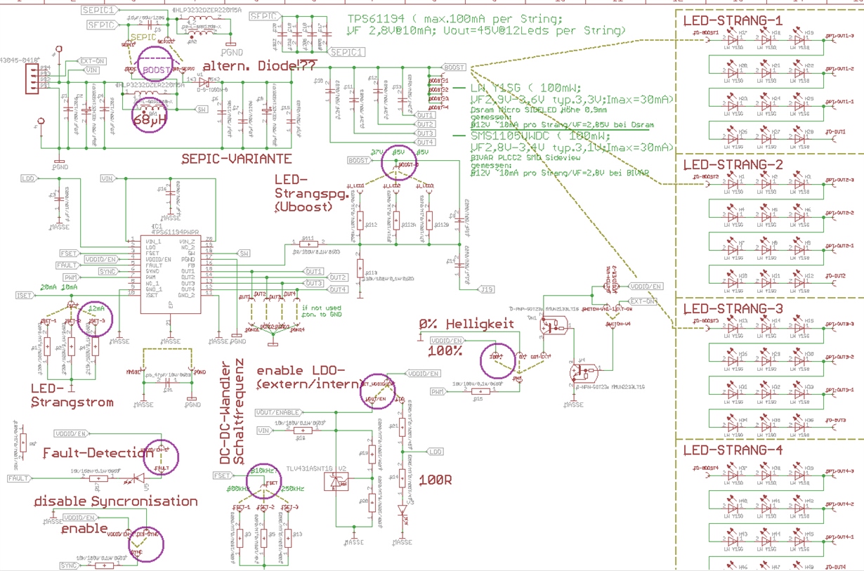

i had build my own evalboard for the first steps with the TPS61194.
I integratet 4 lines with 12 Leds (VR=2,8V@10mA).
First: one line with Uout=35V/Iset=10mA (1 Output)  ==> the Leds shined bright for round about 30 sec., then they go out (no failure-led)
Second: two lines with Uout=35V/Iset=20mA (1 Output) ==> the Leds shined bright for round about 30 sec., then they go out and at once when I enable the driver the failure led is going on...
I changed the output (from 1 to 4) same procedure .... same result!!??
What can be the reasons?
Thanks in advance.
