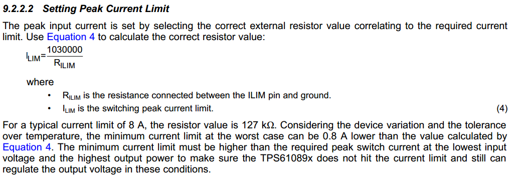

    My customer would use TPS61089 device to convert (2.7~7.2)V supply to 11V. According to the datasheet, the minimum current limit at the worst case can be 0.8A lower than the calculated value. So if the limit current is 100mA, the calculated peak current limit (ILIM) should be 900mA. Is it correct?

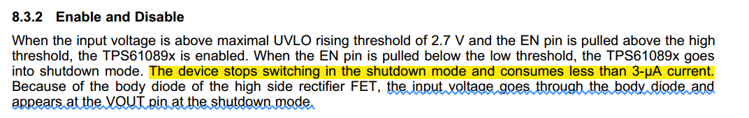

    In addition, when use disable function, if output is open, is there any issue or notice? Thanks a lot!
