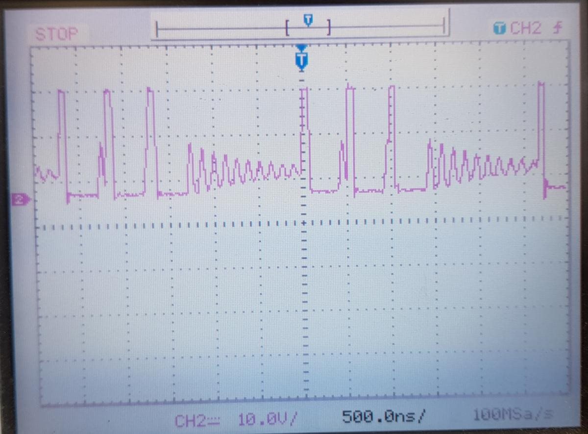

    The output SW pin shows the following in PFM mode:

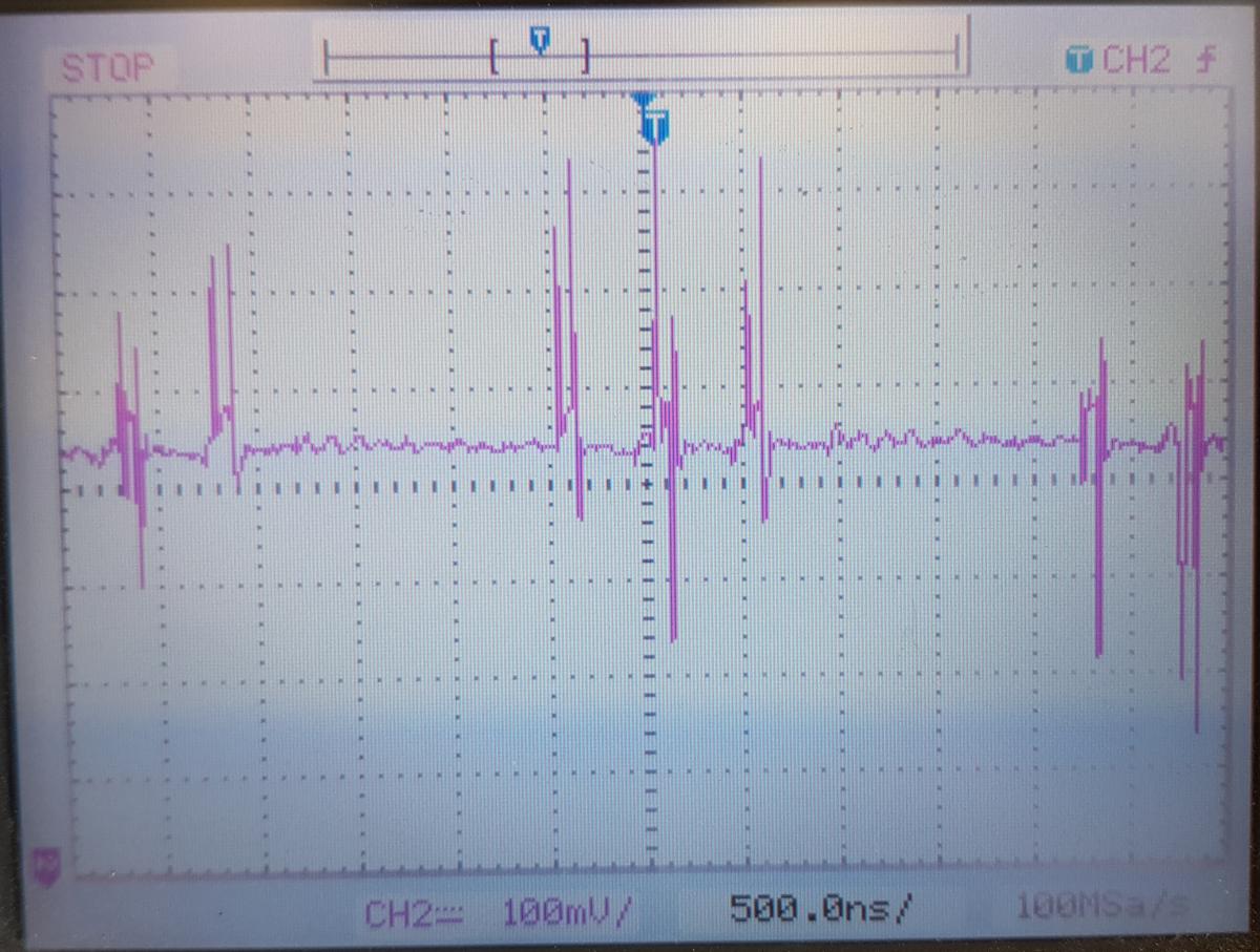

    On the output of the filter, it is much reduced:
    However zoomed in shows ~ 200 Mhz noise:
    This noise is what makes it into our microwave components and exacerbated by an amplifier to show sub-harmonic (relative to our microwave signal) noise all over the spectrum.  The bypass caps on the microwave components don't do much.

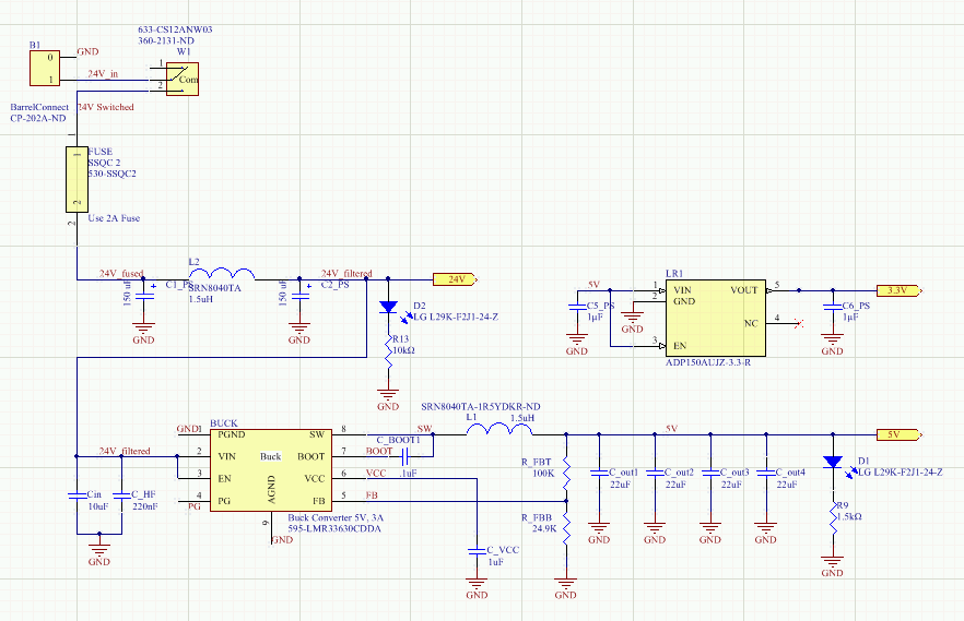

  • Yep.  That's exactly it.  Here is a schematic (it includes a linear regulator):
    Thank you

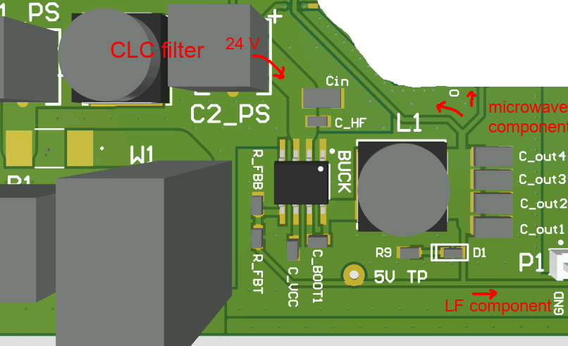

  • I forgot the layout.  See below:
  • David,
    There appears to be a cut in the GND plane between the PGND pin and the negative terminals of the input capacitors. This will create a large loop with lots of parasitic inductance in the path of this discontinuous current. This will cause excessive ringing on SW which will shoot through the parasitic capacitance of your inductor. This is probably why you are seeing so much noise on the output.
    Try adding a wire connecting directly from the PGND pin to the negative terminal of the C_HF cap. This should help greatly.
    -Sam
  • That helped significantly.  Noise was reduced by 20 dB!
