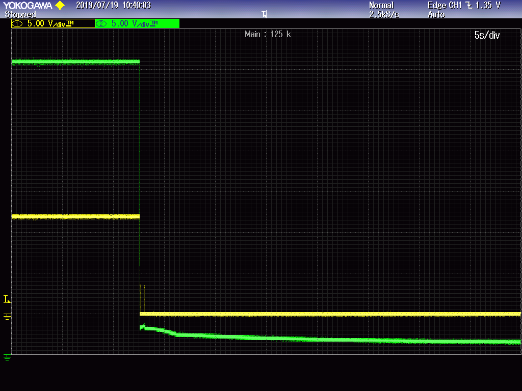

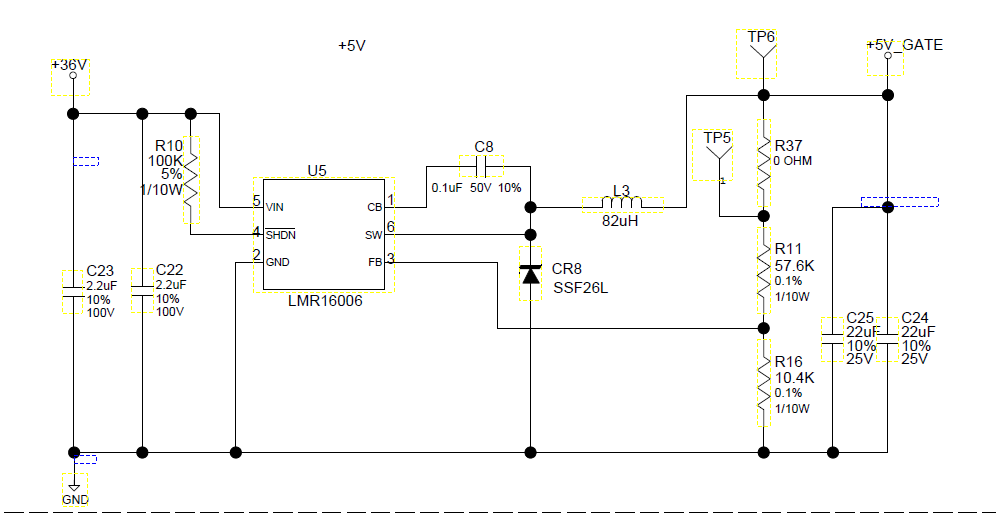

Hello
I am using two LMR16006Xs to generate 5V 250mA and 12V 100mA. The input voltage is 36V. I am also using TPS54360B to generate 24V 0.8A. The figure below shows the shunt down waveform of 5V, 12V and 24V.
The yellow is 5V,  green is 24V and red is 12V. blue is input voltage 36V. You can see the two LMR16006s are trying to re-start when power off and TPS54360B looks good. Take a look at the input, it was appeared when the input voltage drop below 3.8V where is close to the UVLO rising threshold. How to prevent the re-start? I attached the circuit.
