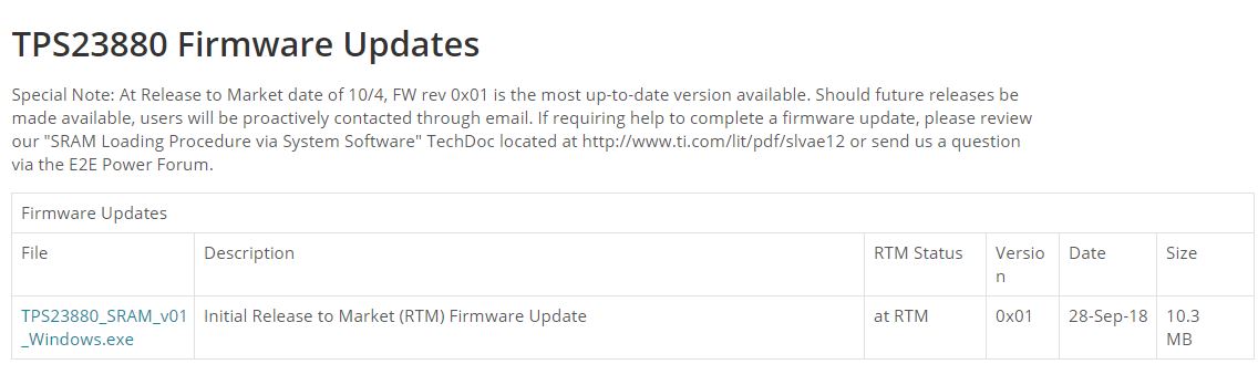

    Looks like you are loading TPS23881 SRAM code to TPS23880 device. If your device is TPS23880, you should download TPS23880 SRAM code. The SRAM codes for TPS23880 and TPS23881  are different. Thanks.

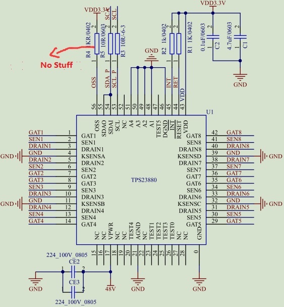

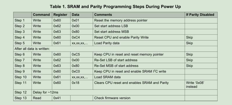

    Did you run the MSP430 code with TPS23880EVM and found this issue? Can you double check if you follow the SRAM loading steps in this tech note? Can you please send me your schematic and software flow chart? Thanks,

         We run the sram_code.c with our PCB(not TPS23880EVM).We followed the SRAM loading steps as below:
    Our schematic is below:
    After burning the sram_code.c file we found the SRAM Version is 0xFF by reading address 0x41,it looks like that TPS23880 go into the safe mode.We can read the IC version(the value is 0x21) and operate the other registers successfully so we make sure the I2C sequence and communication is normal. What reason can make the TPS23880 go into the safe mode durning burning the sram_code.c file?

    I suspect your loaded TPS23881 SRAM code to TPS23880 device.  Can you please follow steps below to to check the HW and SE setting?
    1. Read device ID register 0x43. If it is 0x21, it is TPS23880. If it is 0x22, it is TPS23881.
    2. Please download TPS23880 SRAM code (should be 0x01) from TPS23880 mySecure software and replace the SRAM code array in the MSP430 code.
