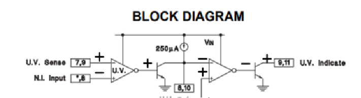

1. Our customer would like to confirm what is the name of the symbol below in the block diagram of U.V. Sense and N.I. Input of UC1543:
2. When U.V. Sense voltage is above N.I. Input, does the U.V. Indicate voltage go to Vin and if the U.V. Sense voltage is below N.I. Input, does the U.V. Indicate voltage go to 0V.

  • Hey Johnathan,
    1. I'm unsure what you mean by "name of symbol". Its a comparator with an inverted output.
    2. This answer had to be correct please see below.
    Daniel

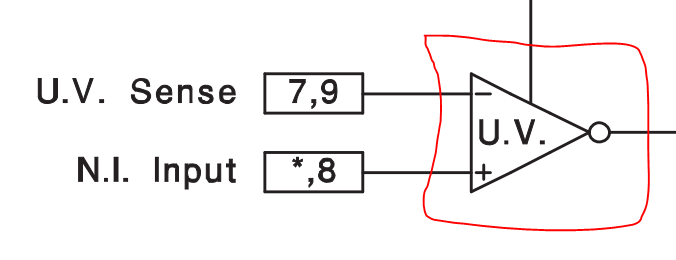

    I have some questions about this image. I understand this image shows a comparator with an inverted output. That is how I see it as well.
    But this is how I understand this part of the schematic.
    If the U.V. Sense voltage, inverted input, is greater than the N.I. Input, non-inverted input, the comparator goes low or -Vcc. Then the inverted output takes it high or +Vcc.
    Please help!
    Cole

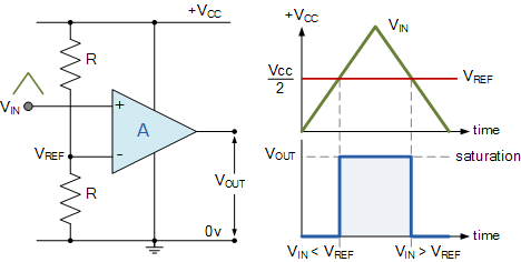

  • Hey Cole,
    I believe I misinterpreted things.
    In a normal configuration the OP AMP will go low when the negative input is higher than the positive input. Since it is inverted, we see the opposite. Thus you are correct.
    Unfortunately this ends up changing the way the output will go:
    This means U.V going high causes the output to go high.
    Daniel
