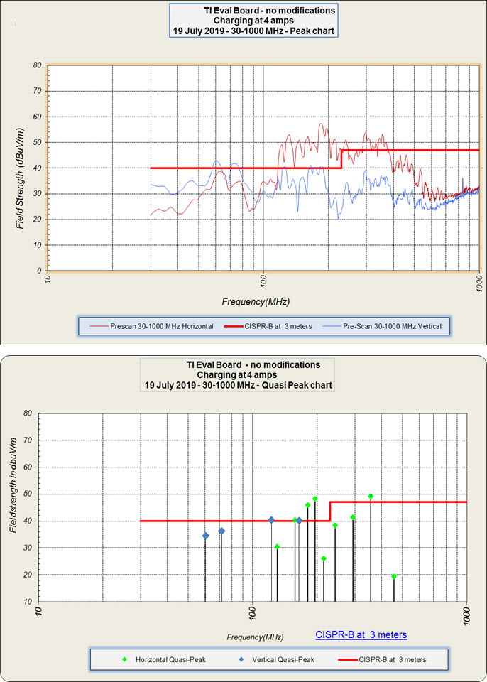

    I want to emphasize that right now,  we are simply trying to make the TI eval board BQ24170EVM-610-15V (EVM) pass EMI testing.
    Why are we testing the TI EVM?  Our own board using this part is failing, we identified conclusively it is due to harmonics of the BQ24170 1.6MHz switching frequency. Before spending effort adjusting our board layout we want to know that its possible for this part to pass and we want to know what key ingredients are required.  We figure the TI EVM,  with a close to ideal layout (one of the key ingredients),  it the right vehicle for this "prove it can work" test.
    So the discussion in this thread should be entirely about the TI EVM.  If we can make it work/pass EMI then we can proceed with our own board re-layout with confidence.  This is our thought process.
    In all our EMI testing the EVM is configured to charge a 2-cell approx 10AH Lithium battery at 4A.  All tests are run while charging a mostly-discharged battery (ie: BQ24170 is in constant current charging state).  Cable to battery is about 4".  We verified that the input voltage (from a regulated power supply) is solid/stable - no funny oscillations or ringing).
    Out-of-the-box,  the EVM with only the one modification to increase charging current to 4A fails EMI:
    You can see the failing frequencies are all between 100-400MHz.  If we zoom-in real time on any of these frequencies we see a comb of small peaks separated by the 1.6MHz switching frequency, so it's entirely clear the failing frequencies are related to the BQ24170 switching.
    NOTE:  Interpretation of the EMI plots:
    • Top plot is peak measurement.  Being above the pass/fail line does not necessarily mean EMI test failed.  The top plot is useful for comparing one scan to another to get a quick general idea of differences.
    • Bottom plot is the definitive pass/fail measurement.  Worst case frequencies from the top plot are selected for quasi-peak measurements which are displayed in the bottom plot.  If these select frequencies are above the limit then the test fails.
    By the way,  the above results are remarkably similar to EMI results for our own board,  which has a very different layout than the TI EVM.  This makes us think there must be some fundamental thing going on with the BQ24170 that can't be resolved by simply improving our own board's layout to be more ideal.

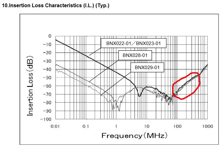

    To answer the question about the input/output cables to the EVM radiating like antennas,  we reworked one of the EVMs (we purchased several) to add really good common mode chokes on both the input and output sides - input/output cables were connected directly to the chokes.  Choke PN is Murata BNX022-01L which has very good attenuation in 100-400MHz region:
    Use of the chokes did not make much difference at all in EMI - maybe subtle difference in shape of peak measurements (top plot) but still have plenty of failing frequencies measured quasi-peak (bottom plot):
    Conclusion:  Adding EMI chokes to kill emissions radiating from cables had almost no effect.  Therefore the EVM EMI issues are not related to input/output cabling.  By the way I have lots of other EMI near-field sniffing data indicating that the EVM EMI issues are not the cables radiating.  In fact it really looks like the entire EVM board is acting like one big radiator.

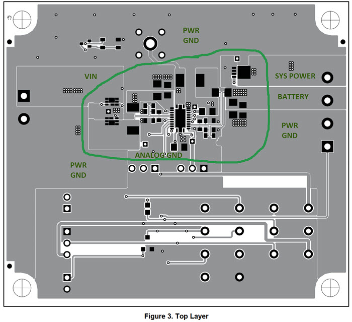

    Jeff you had suggested shielding as something to try.  We considered this but doing so on the EVM looked impractical.  To put an effective shield down one needs to tie it to a common ground all around the periphery of the shield.  The TI EVM has two different ground domains (analog GND and power GND),  and there is really no way to draw a line around the EVM circuitry and tack a shield down to just one of the grounds all the way around.  Plus there are many other signal pour areas around the circuitry that are not ground:
    We think to add an effective shield we'd have to design a custom board with appropriate "ring of vias" into just one of the ground domains all the way around the circuitry area,  so that the shield could connect into the one ground domain through the vias (maybe I should call them through holes).  Since we are trying to make the existing TI eval board work we abandoned the idea of experimenting with shield for now...

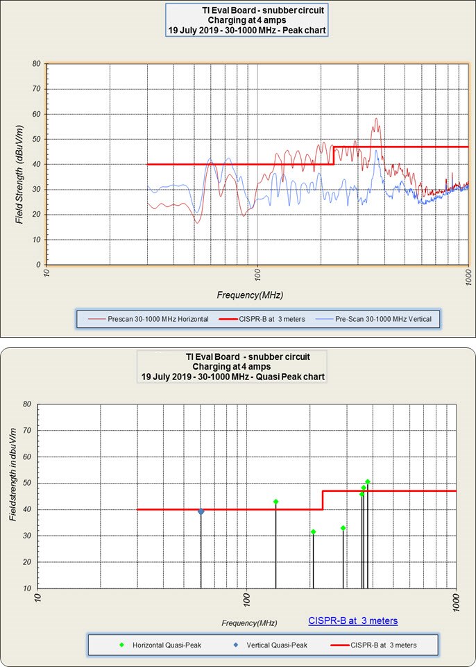

    Next we tried adding a snubber according to the design procedure in this white paper: http://www.ti.com/lit/an/slyt465/slyt465.pdf (which I think is the same procedure called out in the app note you referenced).  We measured the ringing frequency in the EVM to be 180MHz and following the design procedure ended up with subber components of 680pF and 3.75 ohms.  Adding these snubber components to the EVM did very effectively remove the 180MHz ringing from the switching signal when viewed on an oscilloscope (1.5GHz scope using 1GHz very low capacitance active probe),  but did not solve all of the EMI problems.  Here's the EMI scan with snubber installed:
    You can see in the above plot that in fact the snubber did push things down in the ~180MHz region,  but did not help at lower frequencies and seems like it pushed 300-400MHz range up a bit (I've seen this before with snubbers effectively hitting the frequency they are designed for but then pushing up at other frequencies).  None of this is surprising because the snubber in this case was designed to suppress just the single 180MHz ringing frequency,  not the broad swath of frequencies being emitted by the EVM board.
    As a quick experiment we "tripled" the snubber:  three 680pF caps in parallel and three 3.75 ohm resistors in parallel.  This doesn't change the snubber's corner frequency but definitely pulls more energy away from the switching node at frequencies above the snubber corner frequency.  Purpose was to see if we could squash the 300-400MHz frequencies,  and we did:
    So it seems the TI EVM requires snubber to control EMI.
    But from the above plot you can see the TI EVM still has problems below 180MHz even with the triple snubber (C=2040pF, R=1.25).
    We think our next step should be to increase the triple snubber capacitance to lower the corner frequency down to about 120MHz.  This would mean a snubber circuit with about 3000 pF and 1.25 ohms.
    We haven't tested this yet but would really like to have your opinion about these component values and their appropriateness for the BQ24170 (and the EVM board EMI situation) especially when running at the maximum 4A charging current.  Please comment, thanks!
    Bottom line is that we think "strong snubbing" is the way to make the TI EVM board pass EMI.  We are hoping to get a sanity check from you/TI that this indeed is the general trend you see among your customers for the BQ24170 part - that it generally requires a snubber.  Having this indication from you will help us gain confidence that we can make the part work successfully in our own board.

    Adding a shield is impractical.  If you look at EVM board top side copper and try to trace a path to lay the shield down around the circuitry you will see that the shield passes over a number of different signal pours,  and two different ground domains.  No way to effectively tie the shield down to a single/common ground domain all the way around which is what one needs for good shielding.  So we didn't even try this.

    In the end we found a snubber to be effective.  The design procedure in the app note produced a snubber with 680pF and 3.75 ohms,  and this did effectively kill the 180MHz ringing in the switching signal.  But the EVM board fails across a broad spectrum of frequencies from 100-400MHz.  We "tripled" the snubber to about 2000pF and 1.5 ohms - this was effective at squashing all the frequencies above 180MHz but it still fails a few frequencies in 100-160MHz range.
    So now we're thinking to reduce the corner frequency of the snubber by increasing the C to about 3000pF and keep the R at 1.5 ohms.

    I apologize for you needing to double post. The forum has a staging area for new/large posts to be pre-screened to prevent spam.  Regarding the EMI for the EVM, we have never tested these particular EVMs for EMI.  In the past, we omitted the EMI reducing components in order to market the minimum components necessary for operation and maximum efficiency.
    Regarding 1, that much capacitance on the SW/PH node will significantly reduce efficiency on any buck converter and is probably impractical.  The IC has thermal regulation so it will simply scale down the current to prevent damage.

    You've mentioned shielding a few times.  I've never had to shield a buck converter before and it would be difficult to experiment on the eval board for reasons outlined in my previous post - thus difficult to get any data about what shielding does before expending effort to try and wedge a shield into the next layout of our own board. So it's tough for us to be enthusiastic about shielding as a good path forward. But we're all ears if you have prior experience with shielding really helping this class of buck converter - please by all means try to sway us if there's good reason.

    Placement of the input and output caps as close as possible to the IC is critical, even if you have to move the inductor further away.  Same for the RC snubber from SW to GND.  The additional caps at the EVM terminal blocks are more for reducing noise on cables in the test setup.  The resistor in series with BTST should change (hopefully reduce) the value of snubber components needed.
    I personally haven't used metal shielding so can't provide much advice there.  In theory, it should work but will require careful board layout.
