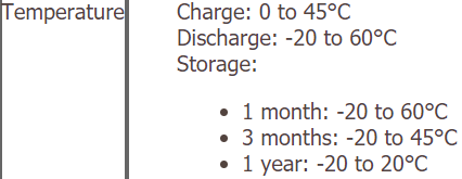

  • Hi Jason,
    Have you been able to get in contact with the battery manufacturer or supplier? Since you mentioned that the BQ25601 can charge new batteries as expected, this seems like a battery issue rather than a charger issue.
    I don't see a datasheet provided anywhere at the link you sent, but I do see the following information in the table:
    What are the operating conditions like in the field? Is it possible that the temperature exceeded these ranges and stressed/damaged the battery over time?

    Its an LG cell. www.batteryspace.com/.../5457_B4.pdf
    The field conditions should be better overall than the temperature in a car "cabin"
    There is NO possible impact of any environmental condition aside from temperature.

    Again, based on the fact that the BQ25601 can still charge new batteries as expected, I suspect that your batteries have been stressed over time such that they fail after 4-6 months in the field. What is the failure rate you've been experiencing?
    We've already discussed the possibility of high temperatures stressing the batteries, but what are your charge current (ICHG) and charge voltage (VREG) settings? If these are too high, then they could also stress the battery over time.
