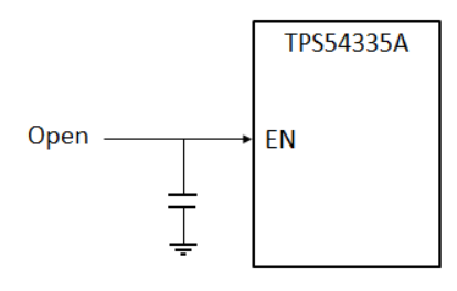

My customer have an issue of unstable startup at EN=floating (1000pF cap).
Issue rate : sometimes
If customer applied 3.3Vdc to the EN pin from external, it didn't occur.

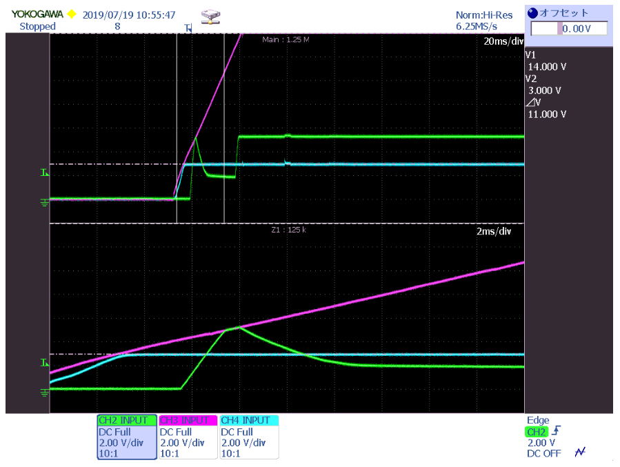

Waveform
Pink, Vin:24V
Green, Vout: 5V
Blue, EN
Could you please let me know the root cause of this behavior?
