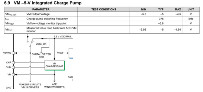

    Do you know why VM pin is -5V?  And how the AFE window comparators use the -5V?

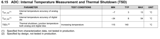

    Max error of accuracy for digital die is 54℃. Do you think that 455A uses this kind of thermistor to do thermal shutdown?

    -The VM pin is -5V to supply a negative bias voltage to the internal circuitry.
    -The temperature values mentioned (54 C) provided for thermal shutdown are only specified by design, and not tested in production (please see footnote 2 in section 6.15 of the datasheet).
