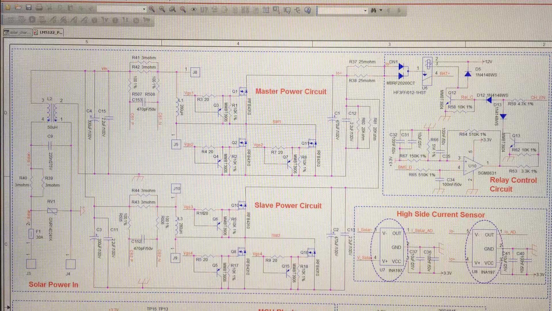

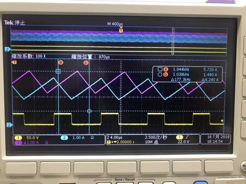

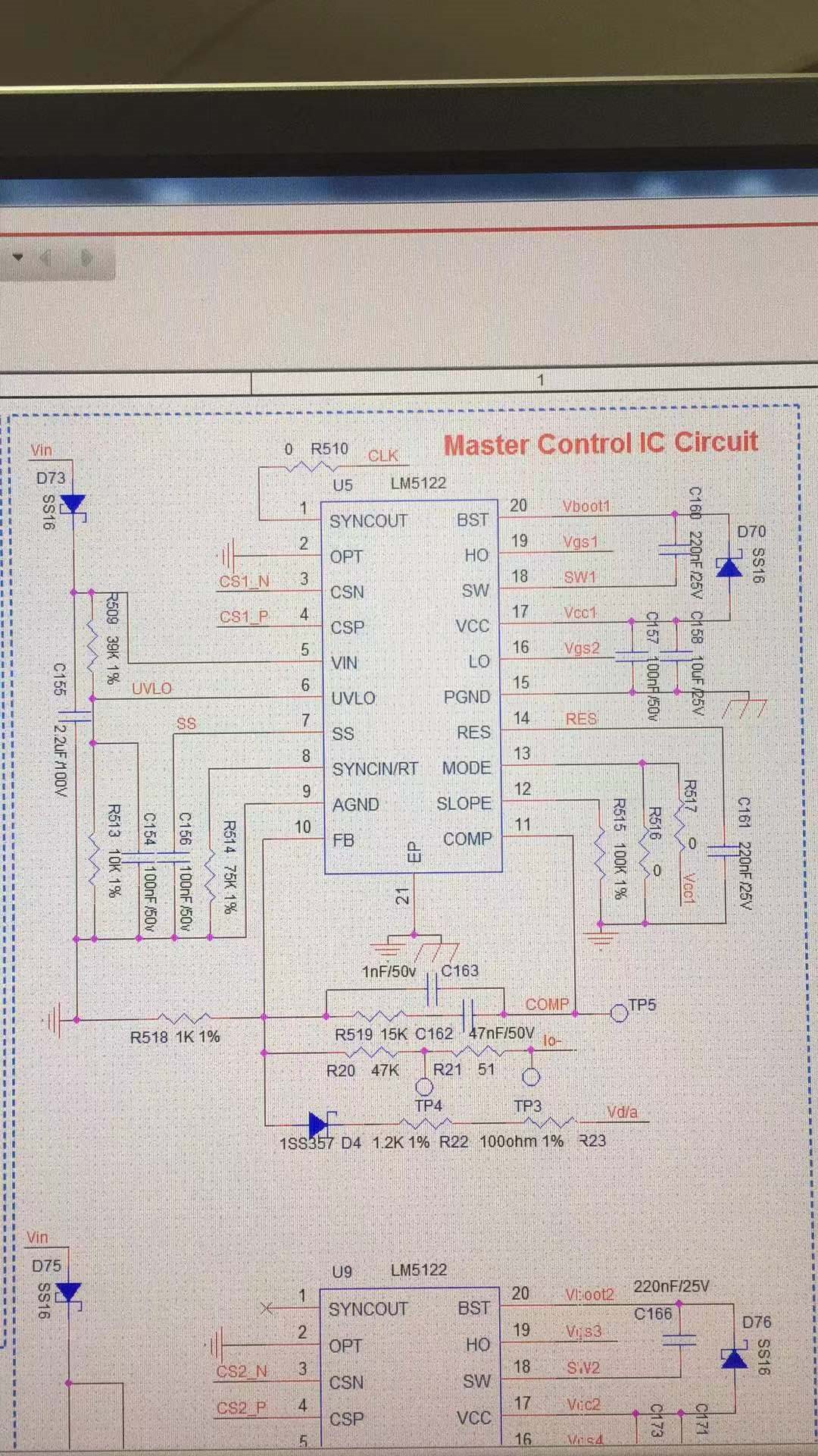

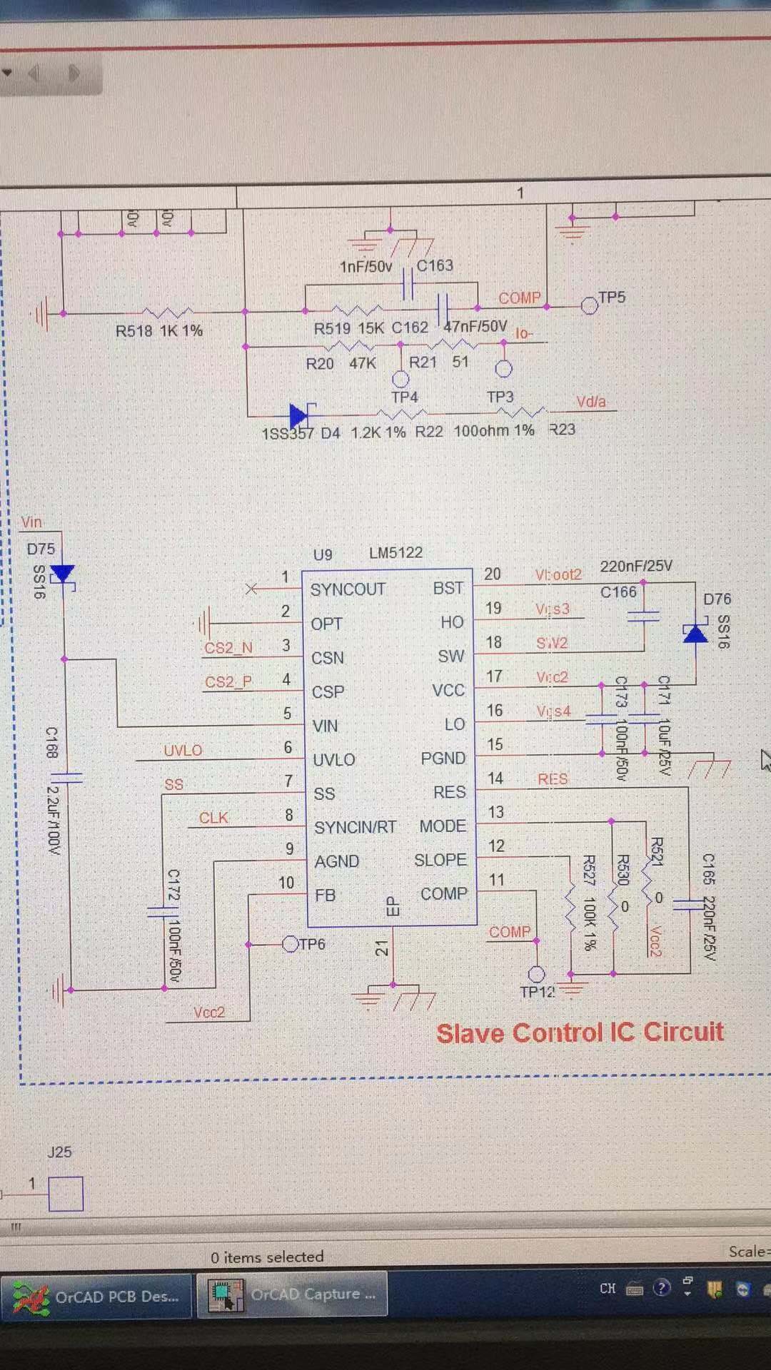

Hi team,
Now customer is using our LM5122 to do a design.
But they find the current of 2 phase is not that balancing as out our EVM.
Could you please help provide some suggestions?
The schematic pdf is not allowed by customer. So only picture could be provided. Sorry about this.
Thanks.
