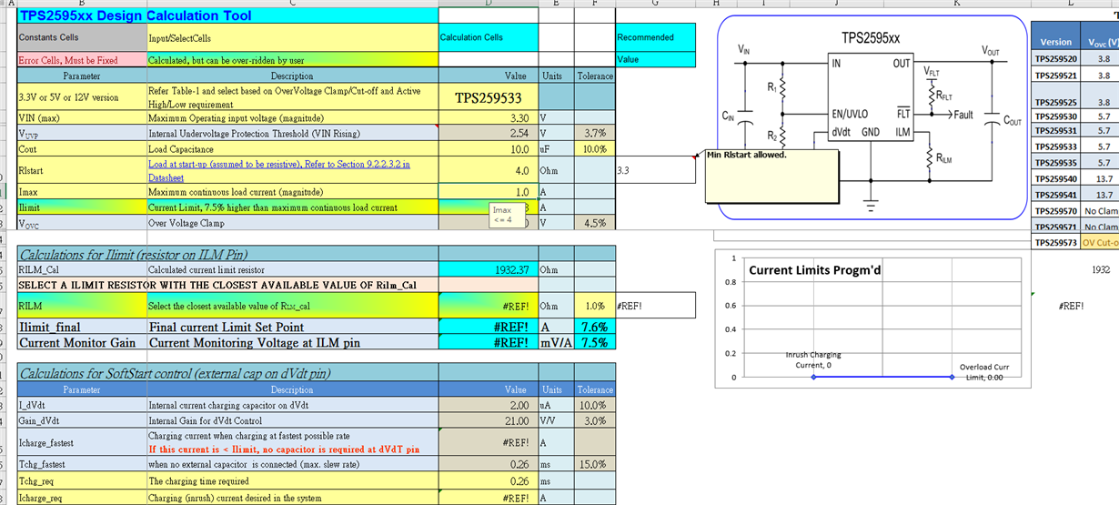

I am designing TPS259533 eFuse in my system.
I download the design tool from ti.com.

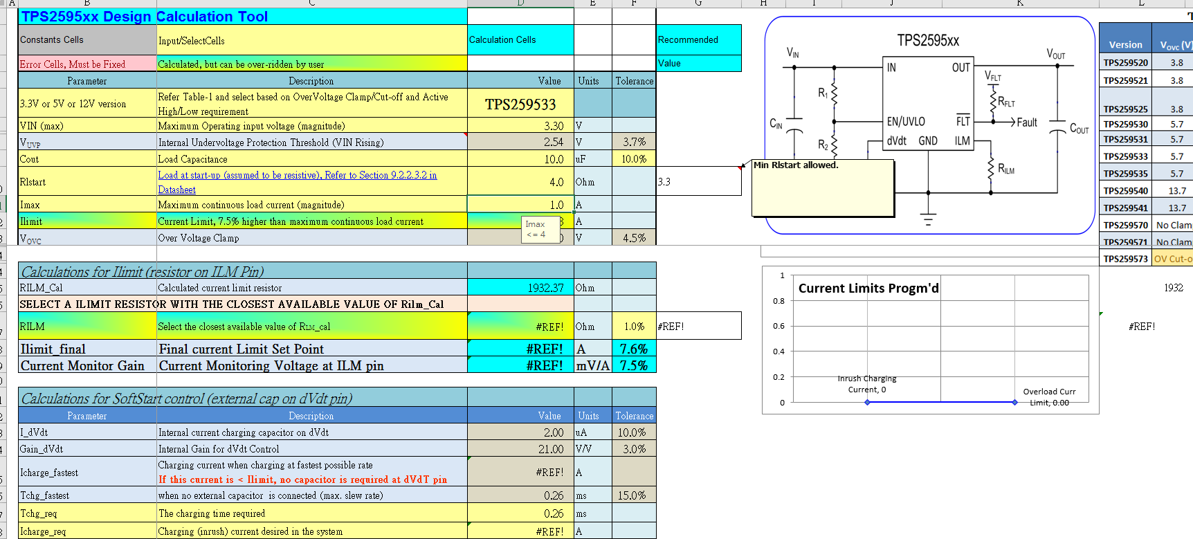

I suffer the issue that when i enter Imax below 1.8A. RILM will show error as #REF!.
Please guide me to fix the issue and i also want to know the reason.
BR,
WeeKeong
  • Hi WeeKeong,
    yes, there is an issue with the tool. We are working on revising the tool.
    Meanwhile, you can formula in cell L35 to “=IF(D35>=10000,D35/100,IF(D35>=1000,D35/10,IF(D35>=100,D35,IF(D35>=10,D35*10,D35*100))))
    This should solve the issue.
