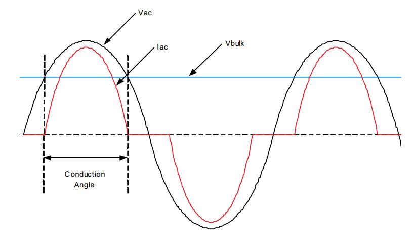

I am evaluating UCC29910A for a Single-phase 460Vac  Buck APFC, 1kW, output 300V. Do you have any design concerns or comments of using UCC299110A for my chase?

    1kW output power is too high for a single phase buck PFC topology. I would suggest using an interleaved CCM PFC such as UCC28070 and use a downstream DC/DC converter to obtain 300Vdc output.

  • Thanks for the reply. Customer is asking:
    If I use UCC28070, it becomes a boost APFC+ DC/DC Buck, two-stage may increase cost and reduce efficiency.
    Right now, I still focus on one-stage Buck APFC approach with 500W target first. Do you think using UCC299110A to achieve 500W/300V output is okay?

  • Hi Viktorija,
    I don't think buck PFC is a good choice for this application, Buck PFC does not conduct when the instantaneous AC input voltage is less than the DC output voltage. With a 460Vac input and 300V output, the conduction angle will be quite narrow and will make it challenging to achieve good power factor.
