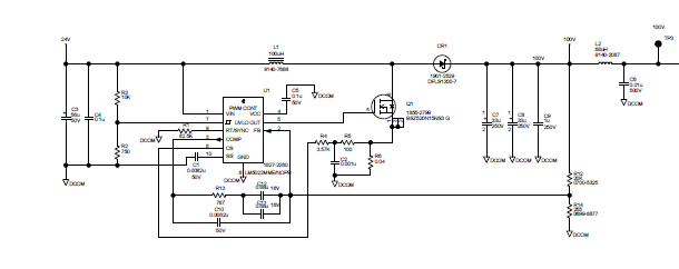

  • Hi Richard,
         Thanks very much for your response. I tried to add a schematic to my original post, but apparently that didn't work - so I've pasted a schematic into a Word document - I hope that works.
    Since the circuit fails after about a minute, I don't think it is likely a start up issue. Other than the Schottky diode, the rest of the components seem to be well above the needs, and exactly what the TI tool had recommended. The FET feels quite cool until the point of failure. There is no resistance between the LM5022 and the FET gate. There could be some ringing at the switch node, though when I looked at it, it seemed OK. I do think that as the load increased, the failure happened more quickly - with no load, I didn't see a failure.
    If you can see the schematic, I added an LC filter at the output of the converter - could that be causing an instability?

  • Hi Tim,
    I'm unable to see the word document, so if you attach an image that would be good. However, adding the system level stability is altered by the extra LC filter, which the TI tool does not take into account. If you remove the extra LC filter, does the converter operate properly?

  • Hi Tim,
    Yes I can see the schematic now, thank you for uploading the image! Hopefully the modification will lead to some fruitful results.

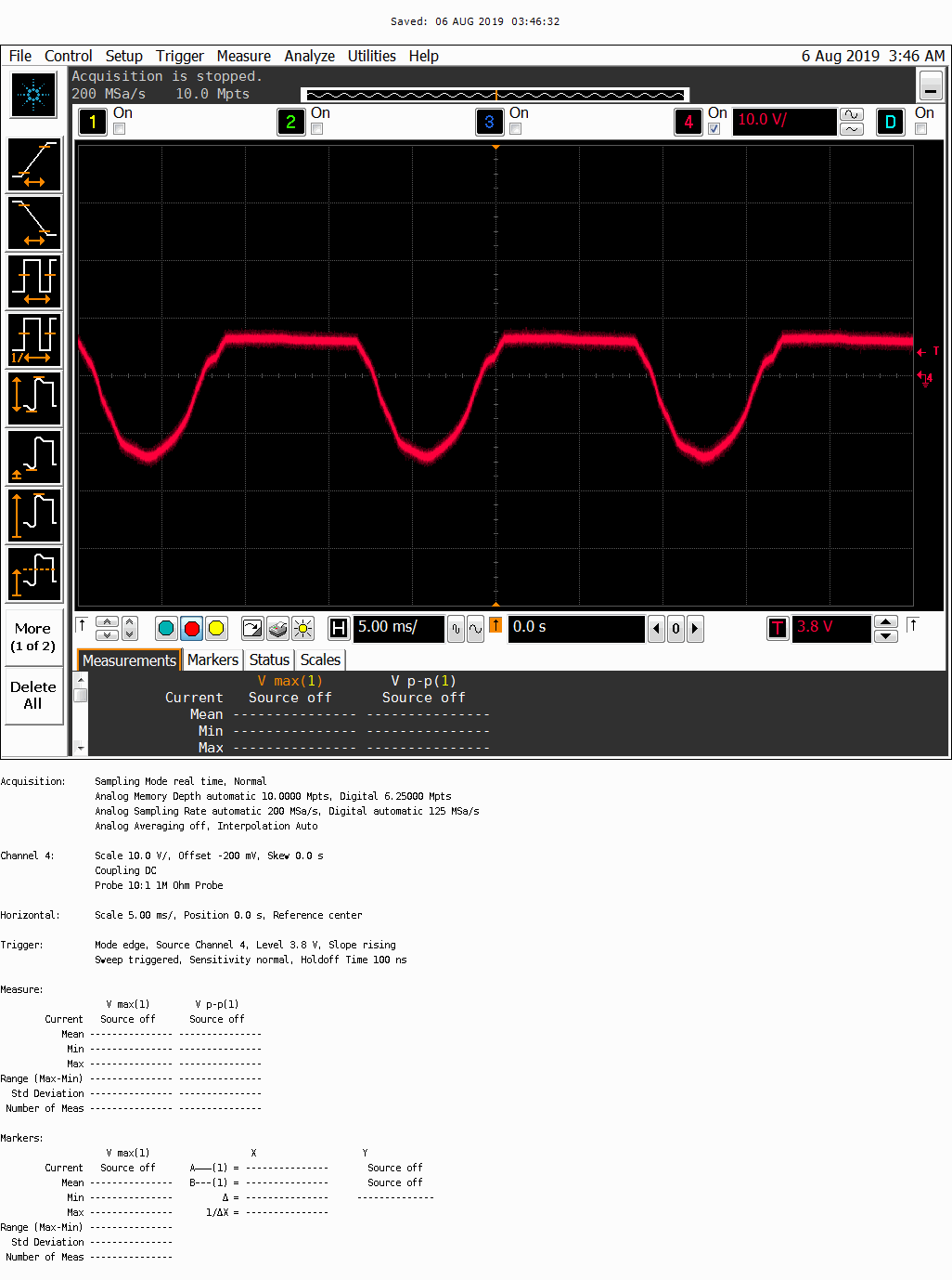

  •  Hi Richard,
           I'm attaching a picture of the COMP pin waveform. Let me know if you cannot see it. I see a similar waveform whether or not a load is attached to the circuit.
    Thanks again for your help.
    Tim
  • Hi Tim,
    Thanks for attaching the waveform- I can see it clearly.
    If current limit was being hit, you would see the MOSFET gate signal terminated until the condition is removed.
    It seems like COMP is dropping below 0V. This seems out of range for the pin of the part. Can you replace the part and take a scope shot of COMP?
    Richard
