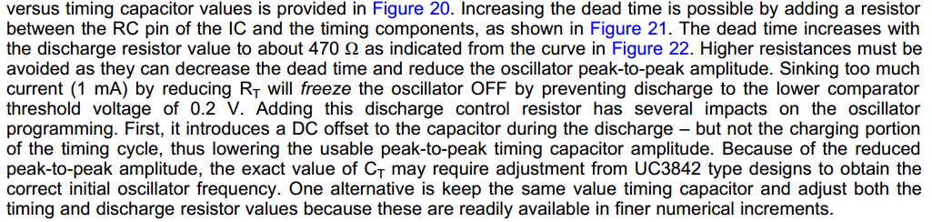

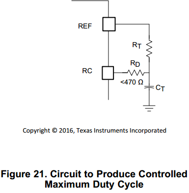

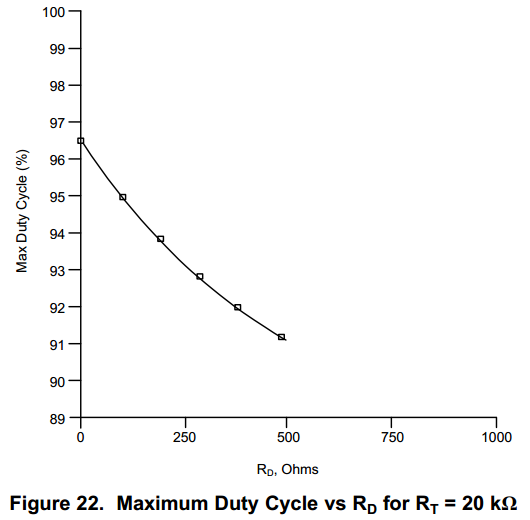

Hi team,
In the data sheet of UCC2803 you recommended the RC timing resistor to be larger than 10k, I wonder what will happen if choose a resistor less than 10k? Customer want to adjust the max duty cycle so they prefer less resistor value. Thanks!
