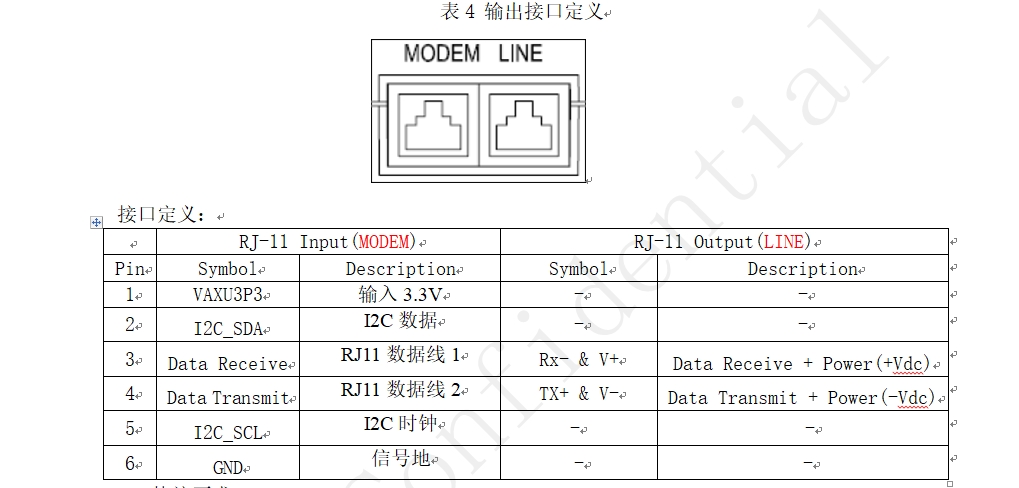

Hi Guys
Do we have solution to support ETSI TS 101 548 SR1/SR2/SR3 power level?

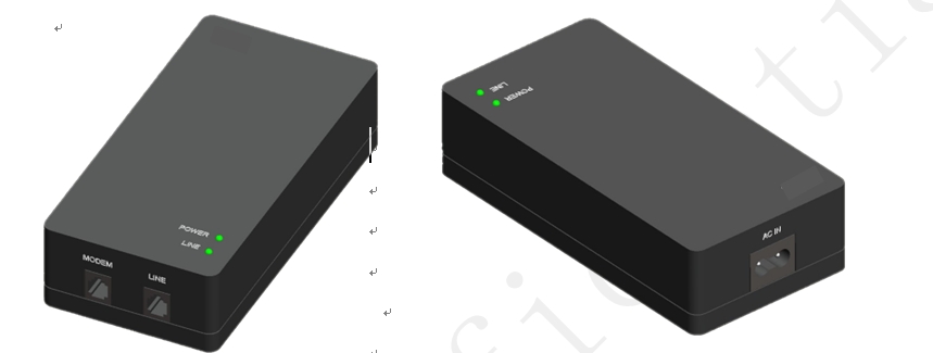

We have a new requirement as below picture: AC input is 90-264Vac; two RJ11 port(one is input and another one is output)
requirement: support ETSI DTS 101 548, SR1/SR2/SR3 power level classification; follow the MDSU power-on startup protocol as defined by ETSI DTS 101 548
Communication speed: 1Gbit/s;
Supporting g.fast function and what we mention above as well. So do we have relative solution?

  • Pengfei,
    Thank you for your question and interest in PoE products from Texas Instruments.
    Our focus is on IEEE 802.3af/at/bt interoperability and compliance; thus, we do not have a portfolio of products well suited for the g.fast application today.  We are keeping an eye on this market and appreciate your inquiry.
