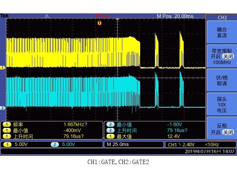

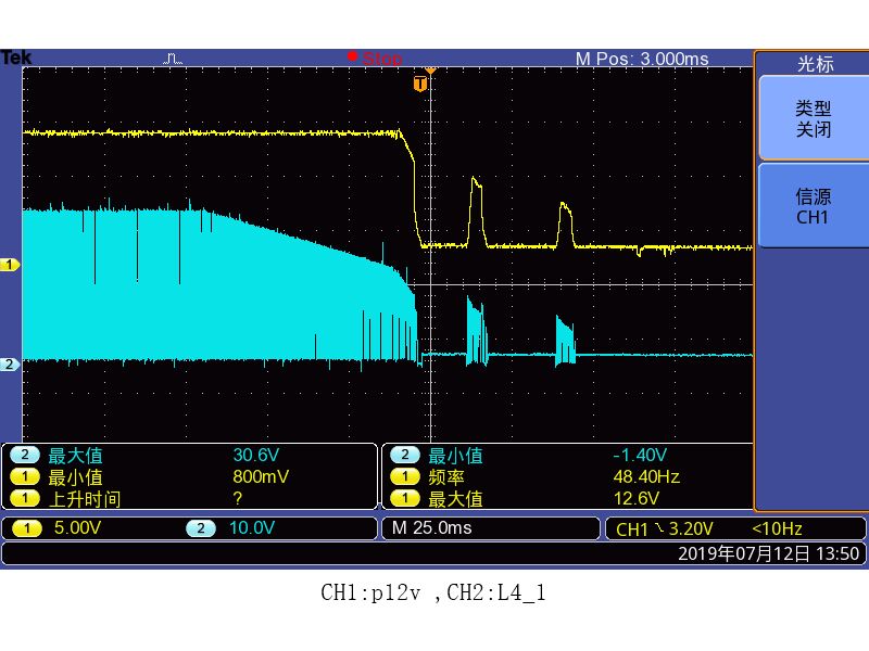

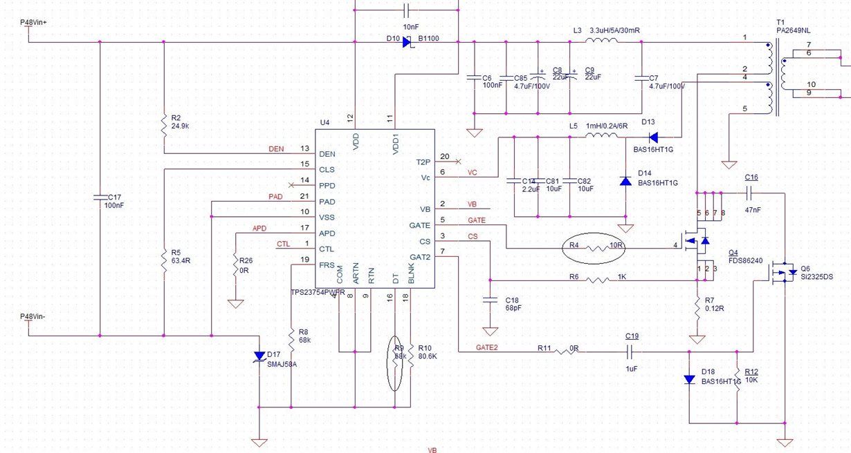

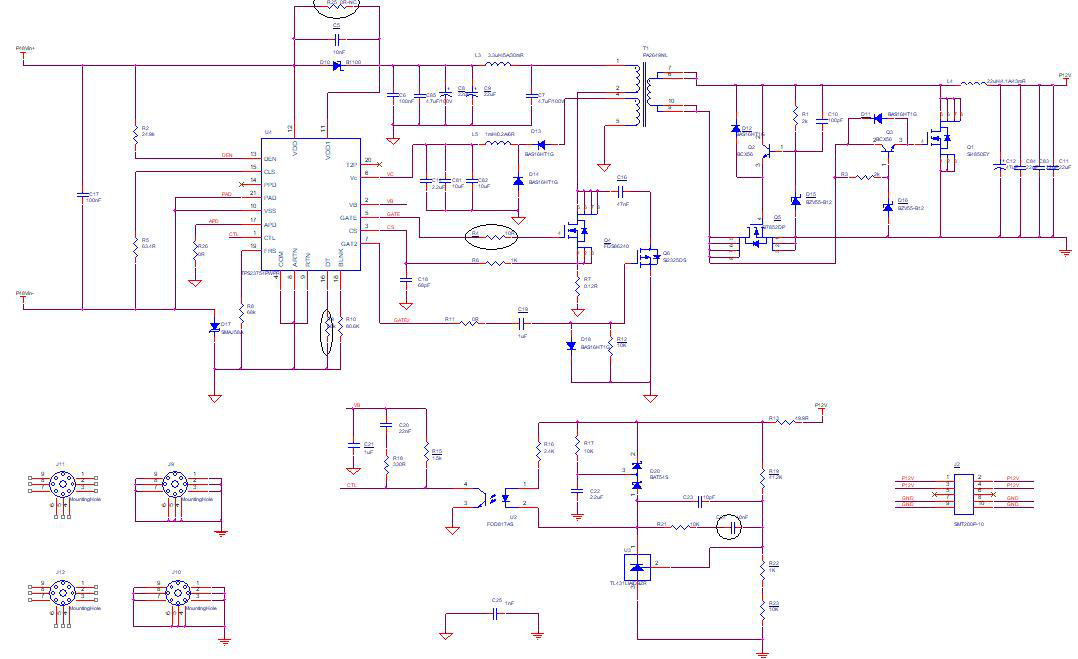

When power off to TPS23754, TPS23754 will output two voltage ripple, how to avoid it? below is my customer's schematic and output gif.

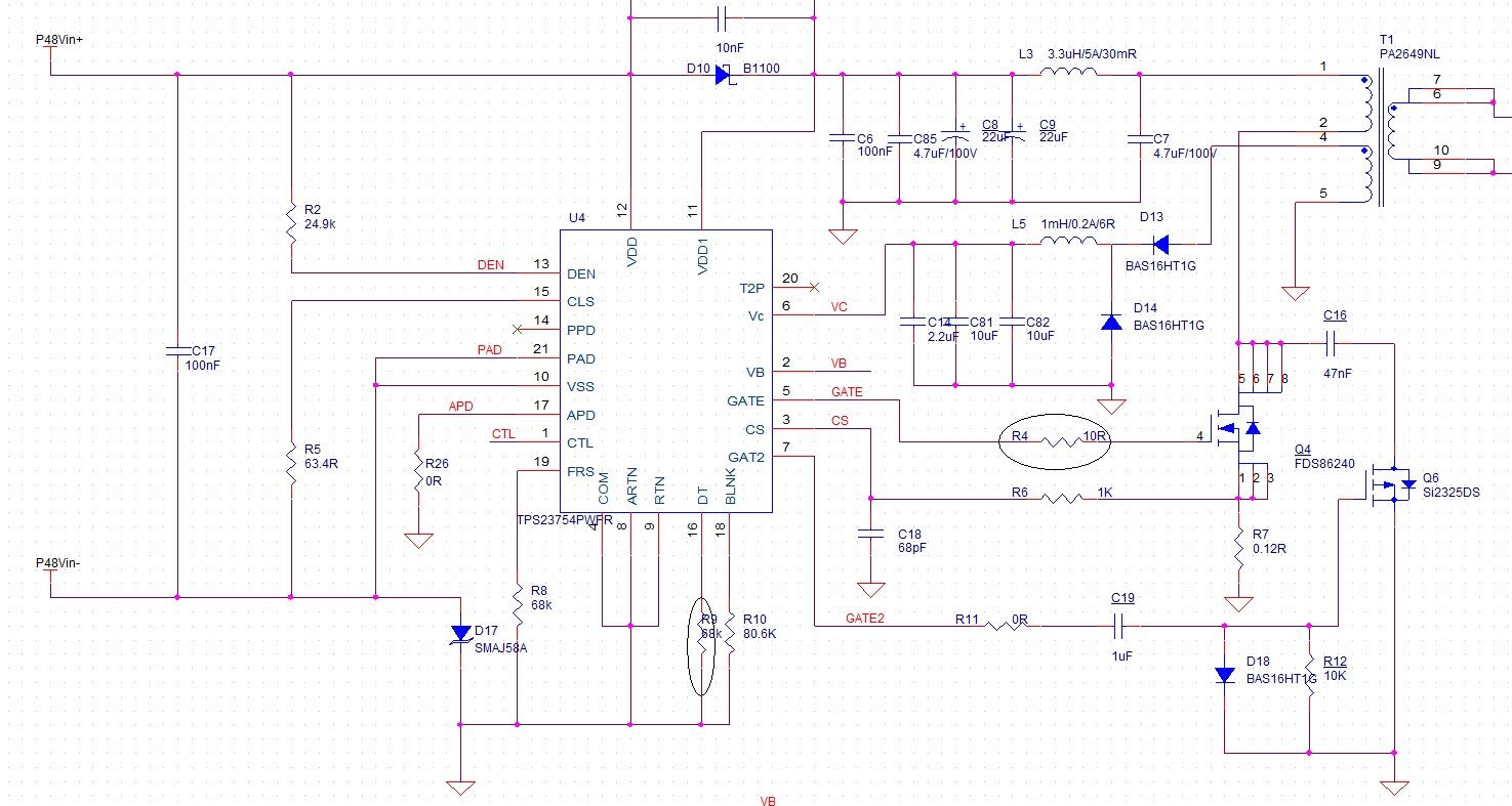

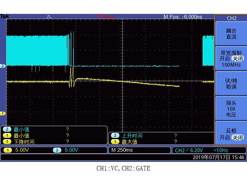

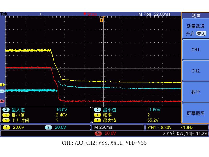

After some internal discussion, we believe that you may be hitting the Vc UVLO. Could you please capture a waveform with Vc and VDD1? This would really help us understand the behavior.
In addition can you provide a schematic that includes the output and also clarify P12V and L4_1. I assume that the P12V is the main output and L4_1 is one of the nodes of the output inductor.

Can you forward the PDF of the schematic? Because I am unable to look at the exact component part numbers/values. Also did you switch any FET components with any alternative part numbers? Please let us know.
