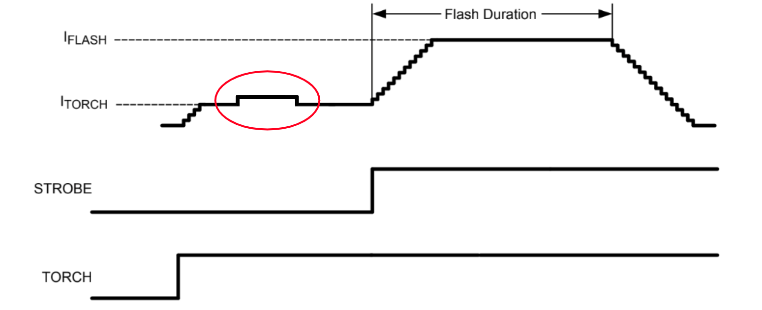

      Customer would like to double confirm it based on LM3644 design.
      It can meet the requirement as the below scenario at torch mode.
    BR,
    SHH
  • Hi SHH,
        We don't have the plan to define it on datasheet yet.
        The answer is yes, you can change the torch current under torch mode.
    Sean
