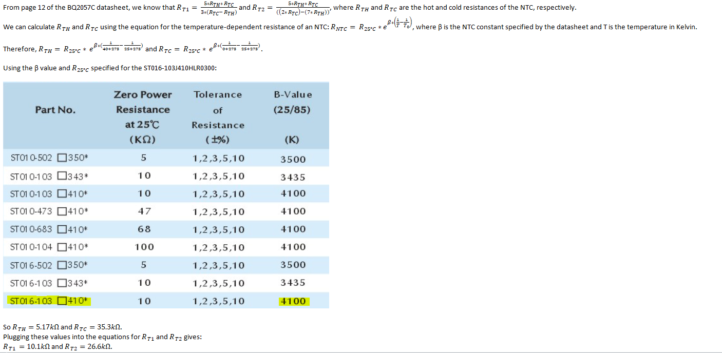

Kindly know how to calculate the RT1 & RT2 value of the NTC block resistor.
Battery: 3.7V/2200mAh
Battery has inbuilt thermistor resistor, value of 10K. Data sheet is attached .
Kindly know how to calculate the RT1 & RT2 and close the charger block design.
NTC part Number used inside the battery: ST016-103J410HLR0300
