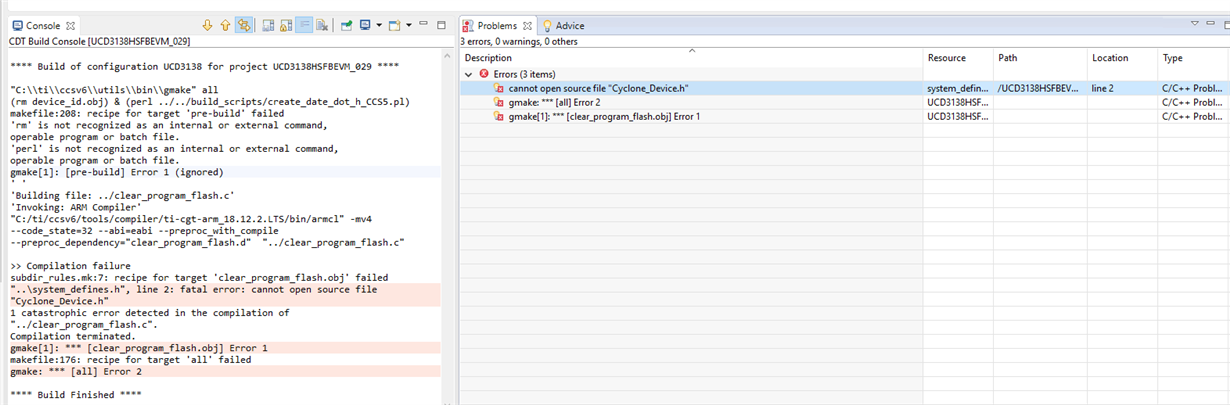

I have recently purchased a UCD3138HSFBEVM-029 evaluation module and have been reading the User Guide, SLUUA95. It appears the module is not shipped with any firmware loaded. Section A.8 in the user guide states the Device GUI is used to download firmware into the board, and refers to “Using the UCD3138CC64EVM-030 (TI Lit#, SLUU886)” for instructions on installing the Device GUI. I have installed HSFBFirmware-1.1, TI-Fusion-Digital-Power-Studio-3.0.36, and CCS9.1.0.00010.
Using the Device GUI I can scan for a device in ROM mode, but I cannot download the firmware as described in the user guide. There was no .x0 file included with the HSFBFirmware-1.1 download. How do I download firmware onto this evaluation module?
  • You'll have to download and install Code Composer Studio.  I strongly recommend that you use CCS 6.2.0.00048,  That's what I'm using, and it's pretty close to the versions that the EVM codes were developed on.
    You can find the versions of CCS here:  software-dl.ti.com/.../ccs_downloads.html
  • Thank you, I am downloading 6.2 now. Should i be able to use the USB-to-GPIO adapter that was included with the EVM, or will i need a separate adapter to install the firmware?
  • The adapter is all you need.
  • Using CCS 6.2, I was prompted to install ARM 18.12 compiler before importing the HSFBFirmware-1.1 project. After installing the compiler I was able to import the project, but there were 2 errors when i attempted to build. "Program "make" is not found in PATH"
  • trying to build the EVM_firmware_test also resulted in issues
  • For the main program, I checked "use default build command" in Project Properties -> Build -> Builder. I then got these errors. Is there a way to download the .x0 file referred to in the Device GUI as instructed in the User Guide for the EVM?
  • The USB-TO-GPIO Interface Adapter (HPA172 as i see it referenced in documentation) is not listed under Target Configuration Connections. I was able to enable ARM Hex Utility so if I can get the TI provided firmware to build, i should be able to use the .hex to flash the EVM using the Device GUI as far as I understand.
    However, i'm running into many issues trying to get the project to build. I am currently at a standstill with the following errors.
  • I've never seen issues like those.  Did you just install the code in the default directory, and then use the procedure I showed you for using the existing project?
    If you start moving things around, you could have lots of issues.  I've attached a .x0 file for the UCD3138.  You can use it with the device GUI to download. You could also use a .hex, but all our projects are set up to make .x0 files.  I had to add a .txt extension on the end so that it would be acceptable to attach in the forum.  You'll have to strip that off to get to the .x0.

  • Yes, it installed at C:\ti\DigitalPower\HSFBFirmware-1.1, although you did not show me a procedure for using the project. I was able to download the .x0 file you provided using Device GUI and was finally able to turn this EVM on. Thank you!
    I am going to do a fresh install of all the software (CCS6.2 and the HSFBFirmware) to see if I can manage to get this to build myself. Could you direct me to this project guide please?
  • Well dang.  I typed in some instructions, and I thought I hid the reply button to send them, but they are certainly not here.
    With the installation, you need to also install the tools for TMS470.  I think that's what our built in projects actually use.
    To install the project, don't use project builder.  Click on the project tab at the top of the CCS screen, and select Import CCS projects.  Either find the directory in the downloaded project that holds the .project file and copy the full directiry description and paste it into the open line at the top of the project window and hit return.
    Or you can browse your way to the directory, and select the project.  Then click finish, and you should have an error free project.
