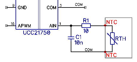

3. datasheet page 24: An internal current source IAIN in AIN pin is implemented in the device to bias an external thermal diode or temperature sensing resistor.
please see below. RTH is integrated in SiC MOSFET module in gray block and there are two terminals called NTC.
a. The voltage across the RTH = IAIN *RTH =200uA*5000k=1V if RTH=5kohms. Is this right?  If it is right, then RTH requires 2.5kohms to 22.5khoms to meet AIN voltage of 0.5V to 4.5V.  Or my schematic is in wrong connection?
b. What is relationship between AIN and APWM? How to monitor the temperature using these pins?
datasheet only provides three special cases  at VAIN=0.5V, 2.5V, 4.5V. I can use one case to set the max temperature but can not monitor the temperature.

    3. Your connection is correct. The voltage at AIN is dependent on RTH*IAN. APWM is a duty cycle output with a frequency of 400kHz.
    The relationship from 0.5 V to 4.5 V is given on page 9 of the datasheet and the relationship between AIN voltage and APWM duty cycle is linear. In other words, the equation could be written as, APWM_Duty = -20*V_AIN+100 where V_AIN is the voltage at AIN and APWM_Duty is the output at APWM in %.
