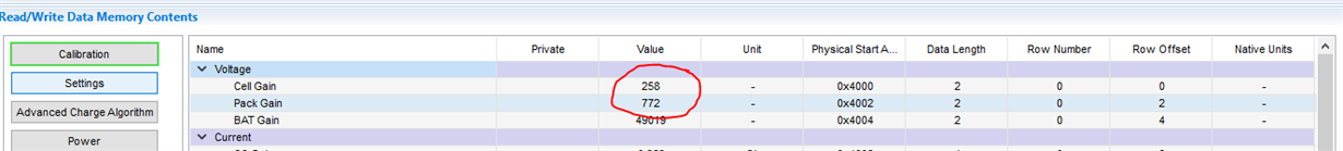

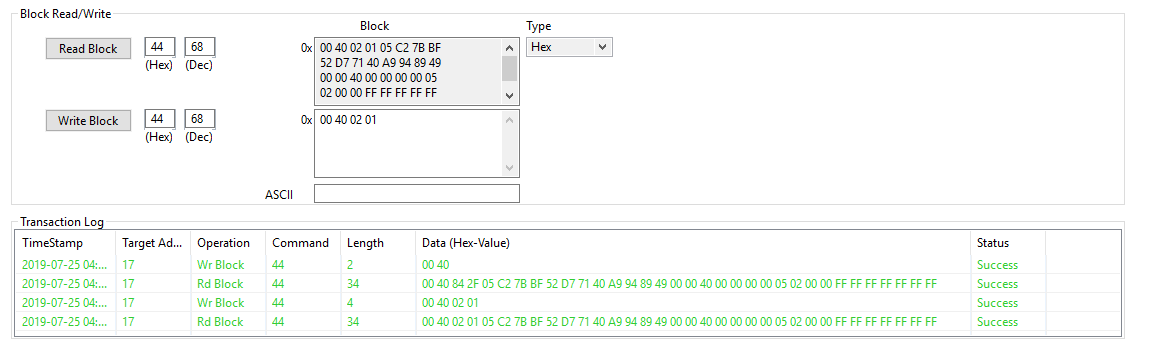

    Using bqStudio on my bq40z50:
    Read of 0x4000, and writing 0x4000, 0x4001 to 0x0102:

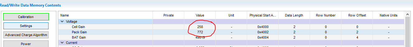

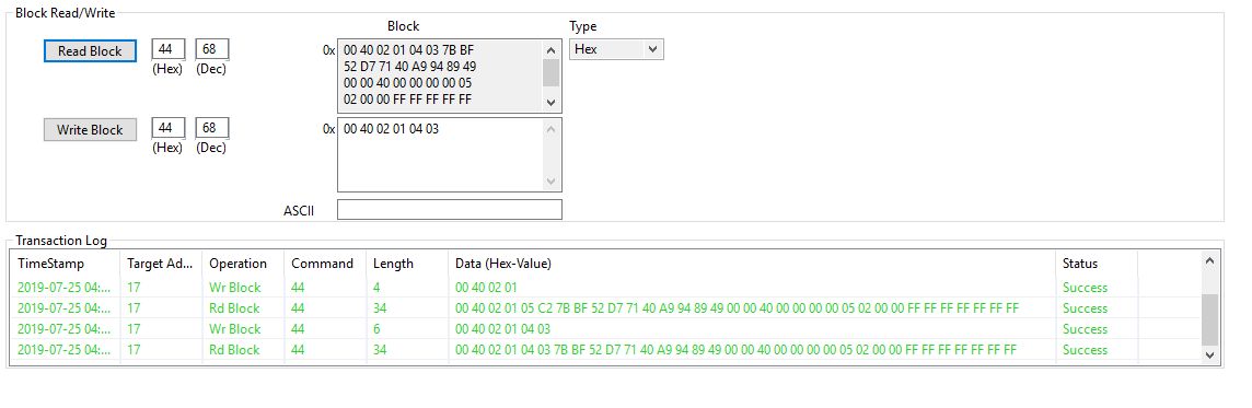

    Write to 0x4000..0x4003 to 0x0102 and 0x0304:
    Read of data flash:
    The Data Flash values change as expected (0x102 hex = 258 dec, and 0x0304 hex = 772 dec)
    From a I2C controller, you will have to provide the length after the address, and typically it will be {0x0B, 0x07, 0x44, 0x00, 0x40, 0x02, 0x01, 0x04, 0x03}
    Can you try it with bqStudio to see if it works? then you can use a I2C bus monitor or logic analyzer to duplicate from there.
    Swami
  • But won't  {0x0B, 0x07, 0x44, 0x00, 0x40, 0x02, 0x01, 0x04, 0x03} be interpreted as the AtRateOk SBS command?   0x07 AtRateOK()
  • We don't explicitly specify the length, but when I monitor it using a bus sniffer, I can see the SMBus address, and the length of the data (in this case 0x07), and then the data as shown above.
    You can see the exact sequence followed in bqStudio in the first two images.
