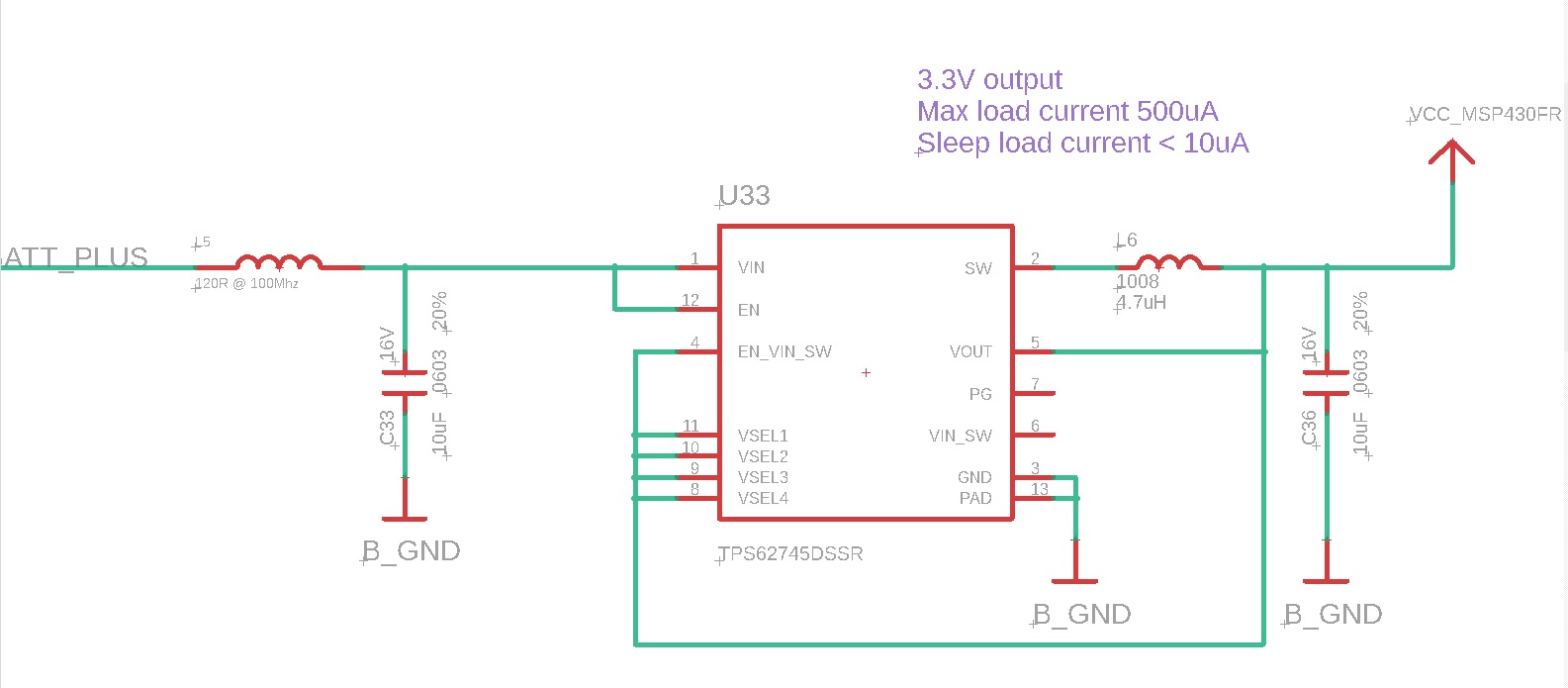

TPS62745: EN_VIN_SW tied high - VIN_SW no connect question
Part Number: TPS62745
I made a mistake in my schematic and connected the EN_VIN_SW pin to the output voltage of the supply instead of ground.  The datasheet says this connects the input voltage to pin6 (VIN_SW) which is usually used for an ADC to monitor the input voltage.  Will this cause an issue?  I have EN_VIN_SW tied to the supply output (3.3V) and VIN_SW pin disconnected.  Schematic attached
