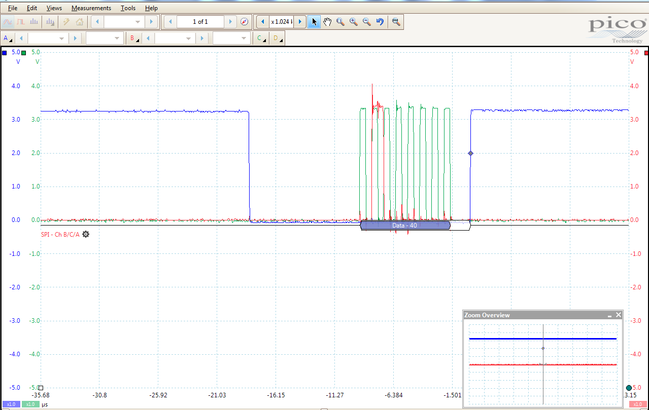

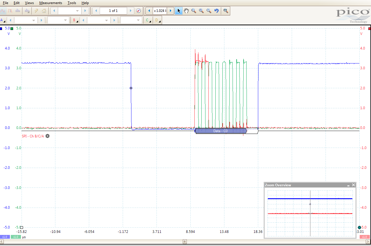

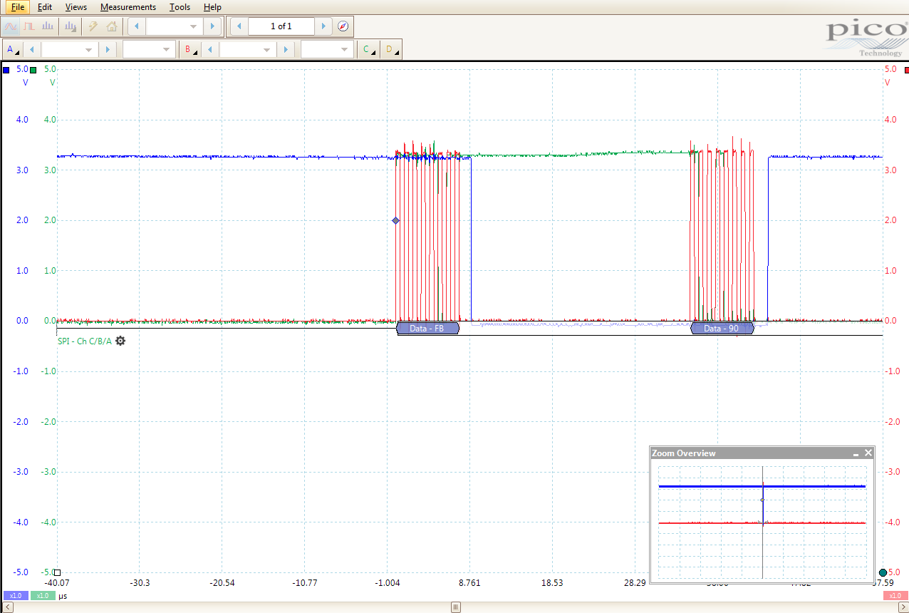

  • Hi Vince,
    As suggested, I captured waveform with the help of picoscope.
    waveform during charging command, discharging command and command sending to one of the cell is attached below:
    charging command:
    Discharging command:
    Command sent to cell 6:
    kindly go through it.

  • Hi Gargi,
    Thank you for doing this, it is just what I suspected! As you can see during the discharging command, the SPI is correctly transmitting 0b1110 0000.
    However, the  VARIABLE g_ui32EMB1428Status is showing 0x00000000. This means that there is indeed a stack overflow happening, and the microcontroller is not properly reading back the data (because it ran out of stack room and can't store the variable anymore).
    Please follow the steps I outlined previously (move all variable/array declarations to the header file) in order to prevent this. Please follow microcontroller software development best practices as well, in order to reduce the amount of stack usage during any function call.
