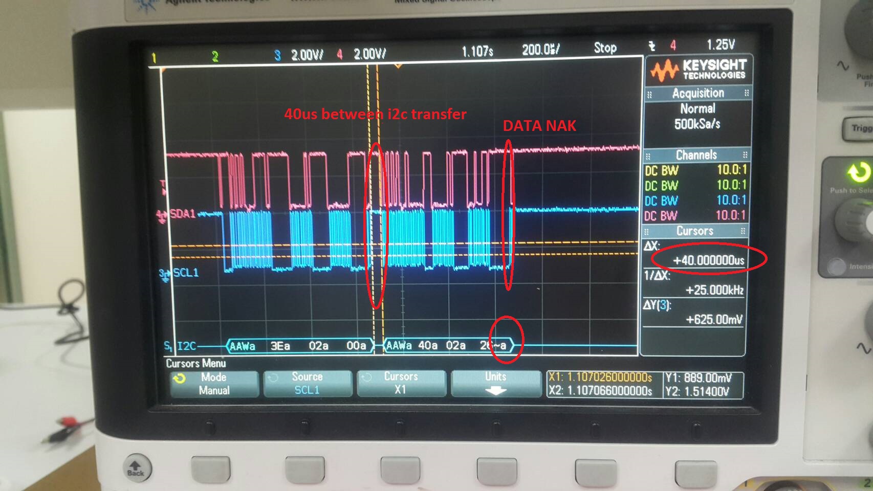

Hi team,
Plesae help on below questions.
  1. GMFS loading takes more than 3 seconds. 1 second for SET_CFGUPDATE and 2 seconds for software reset. Any room to improve (shorter delay)?
  2. During GMFS loading, if the delay between two i2c transfer less than 170 us, the 2nd transfer may get data NAK from gauge IC. The i2c bus runs at 100KHz. Is this delay essential?
