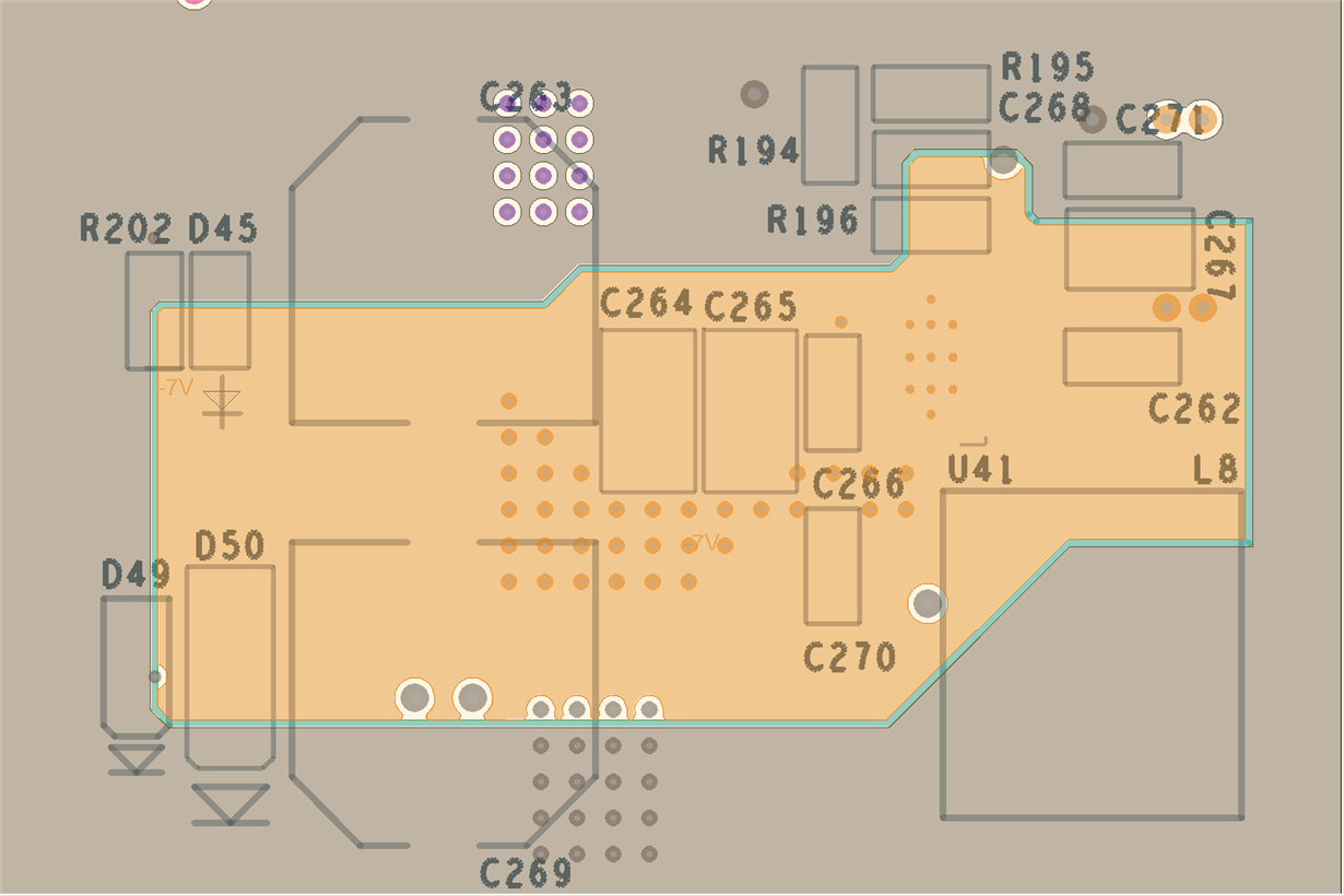

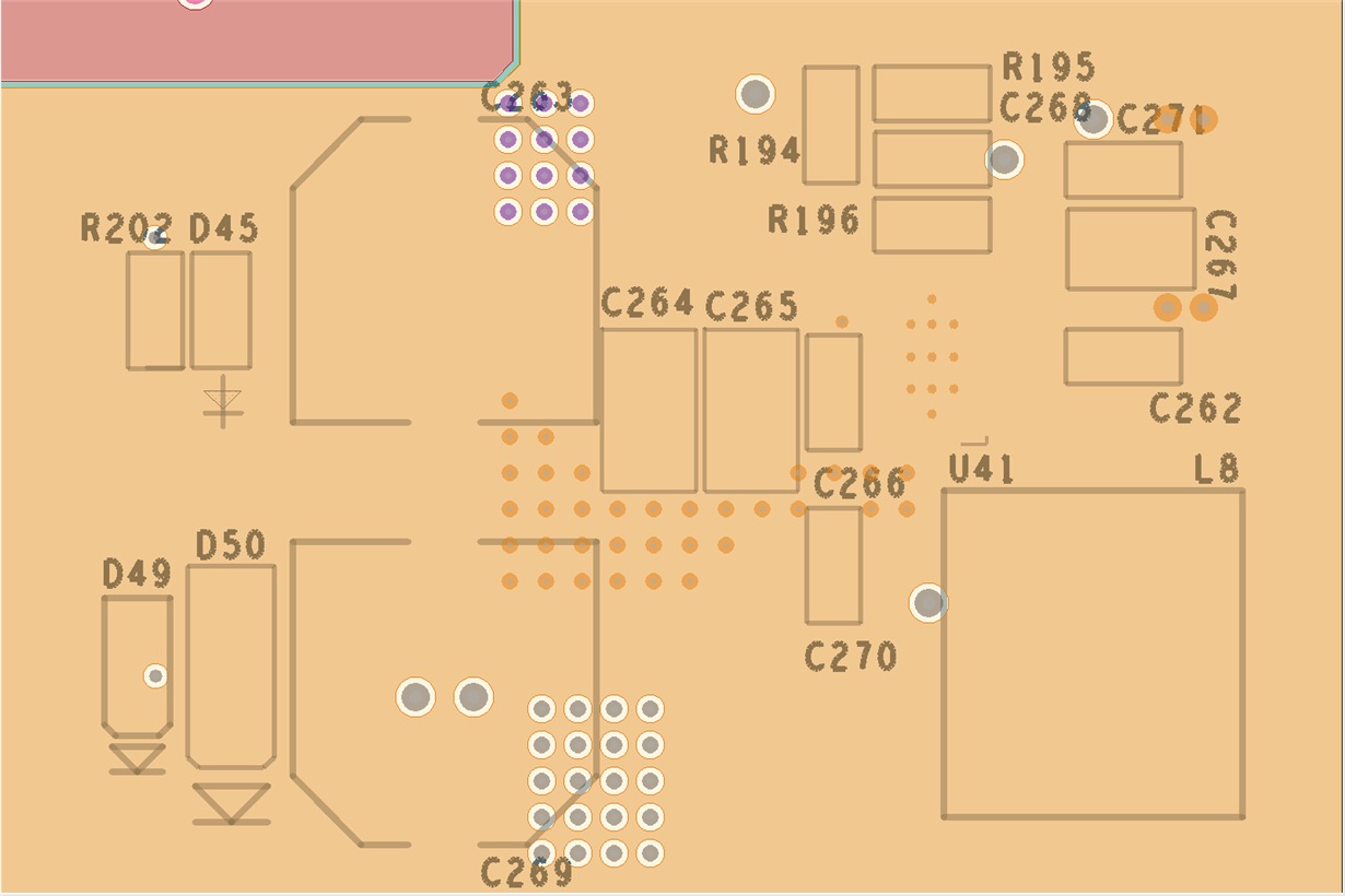

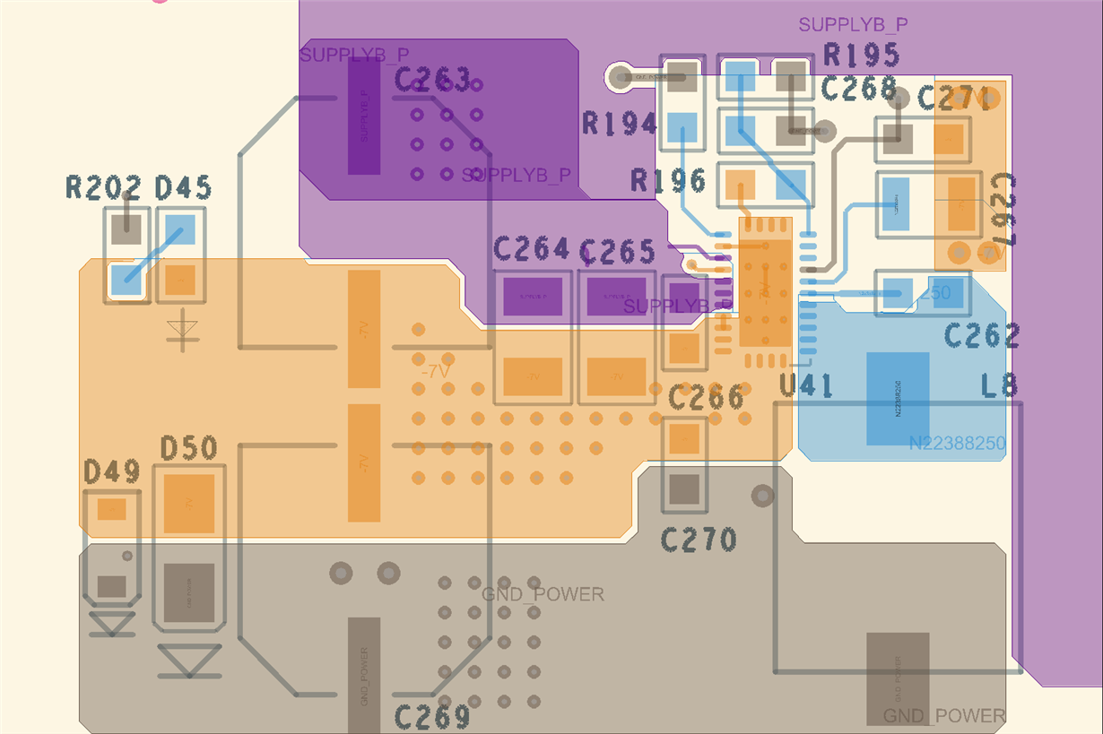

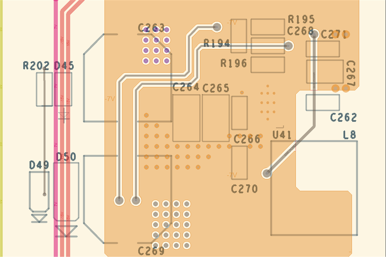

I've attached portions of my schematic detailing the power inlet and the converter itself, images of my layout, and photographs of the failed chip.
Power inlet
LM73606 converter circuit
Layout - Top
Layout - Gnd
Layout - Pow
Layout - Bot

    The schematic looks good. The layout looks good.

    • Accidental shorts due to soldering or assembly - Your picture shows some shiny debris between pins 19 (AGND) and 20 (PVIN). This is probably from the issue event but it may have caused the event if it was there before.

    Just to follow up with those suggestions, though, I'd like to recall your attention to the fact that the kOhm impedances are intact between the switch node and both PVin and PGnd nodes. More than that, the damage to the package is not physically located near the switch node pads.
    Therefore, my main question is: what can fail in the IC between PVin and PGnd pins?

    It's possible that a SW abs max violation can cause this. There is other circuitry on SW which may become damaged which can cause a soft short from PVIN to PGND with no apparent short from SW to these pins.
    Have you compared the resistances of this IC to a known good IC? That will tell you with more confidence if the values you're reading are normal.
    You may also check, as you mentioned, the connection from SYNC/MODE to the board. The datasheet states not to float this pin. If it was floated due to poor soldering, the part may keep switching between modes and could cause issues but I doubt that would cause a blow-up.

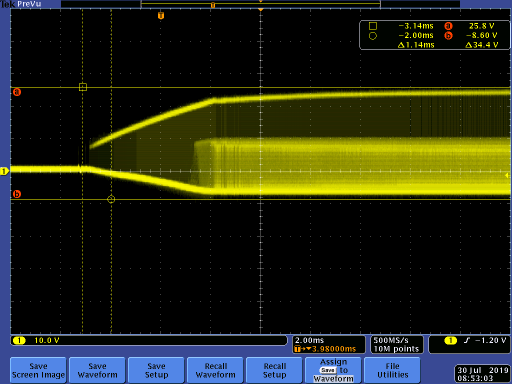

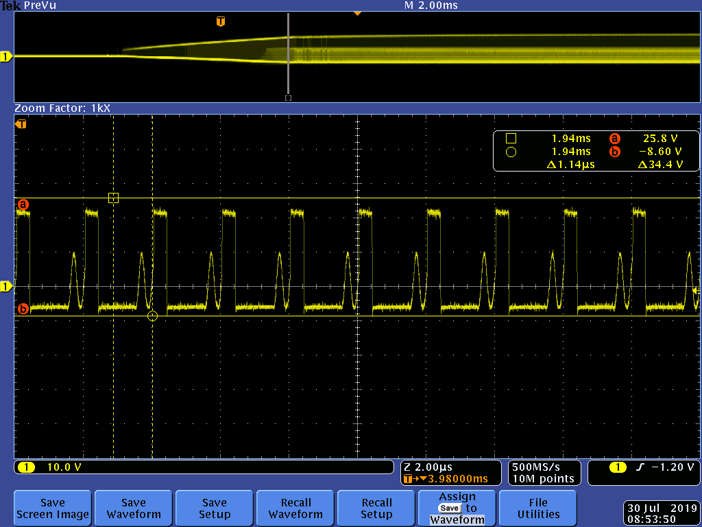

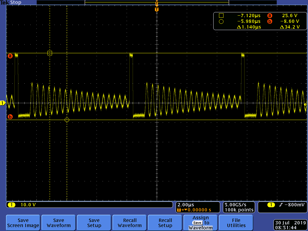

    Also checked the switch node, in normal operation, I've got a Vpk-pk voltage of 34V. I did not capture a scope trace of the start up behavior, and I don't have a captured scope trace on hand. I'll try to get back to the lab soon to observe the start up behavior.
    As far as shape, the switch node voltage is almost a dead-ringer for Fig 59 in the datasheet, except with the peak voltage above.
    Regarding the sync/mode pin, I don't have a good way of testing the connection. The pin flank is too small for the probes we have in house.
    I need to take a second look at the switch node, I'm a little surprised to see it as high as 34v, I'd have expected 31v.

  • Hi Sam,
    Had some time to get in to the lab this AM and grabbed some scope shots. All of what follows are taken from the lead of the SW node of the inductor.Probe Point Illustration
    Start up of the converter:
    Detail #1:
    End of start up trace:
    Steady State:
    Looking at these scope traces, I did not see anything completely awful, I'm a little concerned that the Vpk-pk is as high as it is, but it is still within the limits of the converter. The counter argument to that is this is a a totally different board where the converter has not failed.
    Thoughts?

    The waveforms look good. It may be useful to zoom in to a single rise and fall of the SW node. That way we can see any overshoot with more detail.
    But if the voltage across the converter is 34V, the converter should be fine.
    Make sure you are using the tip-and-barrel method or a differential probe with very short wires to keep the waveform as true as possible.
    It may be time to investigate possible ESD, handling issues, soldering issues, or other ideas.
