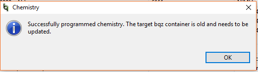

I am currently setting up the bq34z100-G1 for gas gauging of a LiFePo4 battery pack. When programming the ChemID with bqStudio 1.3.86, I see the below warning message. Can you please let me know what needs to be done?
Furthermore, I don't see any controls for the manual/automatic learning cycle (as it is available for bq27541-G1 for example). Is there a way to perform the auto-cycle for the bq34z100 as well?

  • Hi Daniel,
    Please check if your fw version for the bq34z100-g1 is v0.16. If it is not, please update to it by downloading the fw from the product page. The bqz file that comes with it in the package needs to be copied to c:\ti\batterymanagementstudio\config.
    Once that is done, this warning will go away.
  • Thanks, Batt!
    I verified the FW version (v0.16) and copying the bqz file to bqStudio's config folder indeed fixed the misterious warning message. Thank you!
