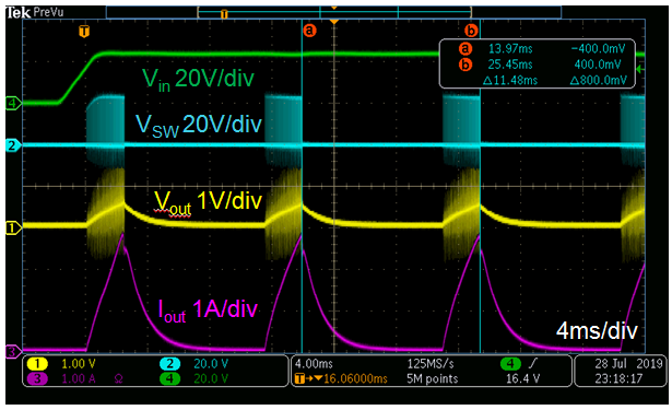

    Here comes a new question, if the IC extends the off-time for 64 consecutive clock cycles to enter hiccup mode, why the frequency continues increasing during the start time with a fixed minimum ton time from my observation on the oscilloscope? The frequency increase from around 300 kHz to 900 kHz. I'm trying to find the start up condition with large capacitive load.
    Thanks a lot !

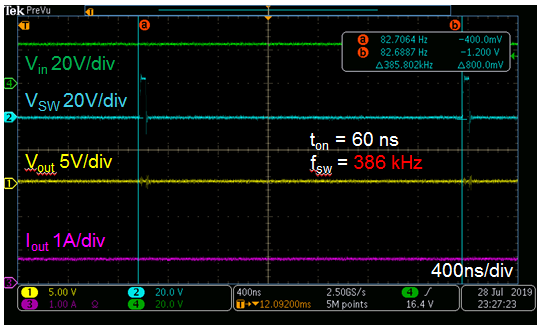

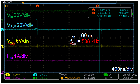

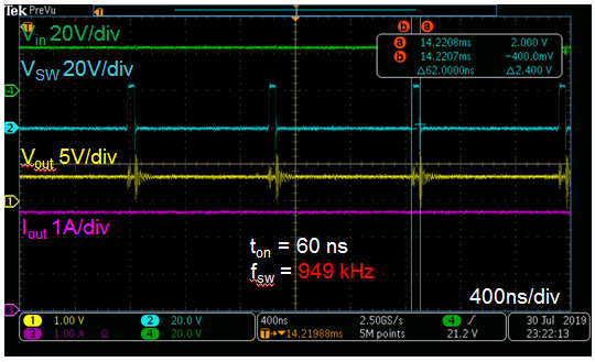

    Sorry, I can't understand it by now. So I record the waveform when the LS switch shutdown and enter the hiccup mode (Figure.1 & Figure.2). However, from  figure.1, the time for LS switch to shutdown isn't 64 consecutive cycle, which reflects by frequency continuous increasing from 300kHz to 900kHz (figure.3 & figure.4 & figure.1). If the current of LS switch is above the LS current limit for 64 consecutive cycles, the off time must be extended, and the frequency will be decreased. Can you help me finding out the reason? Besides,ton is 60ns during the whole process.
    Thanks a lot !
    Figure.1
    Figure.2
    Figure.3
    Figure.4
    Flora
  • Flora,
    The IC, from your waveforms, starts with low current, high VIN, and low VOUT. This will fold back the frequency due to the minimum on time of 60ns to achieve the required duty cycle to maintain regulation.
    Increasing the output current will cause the frequency to increase in order to increase the duty cycle since the TON is still 60ns. This provides more output current and will maintain regulation. The on-time is still 60ns because the switching frequency has not increased to your selected switching frequency yet.
