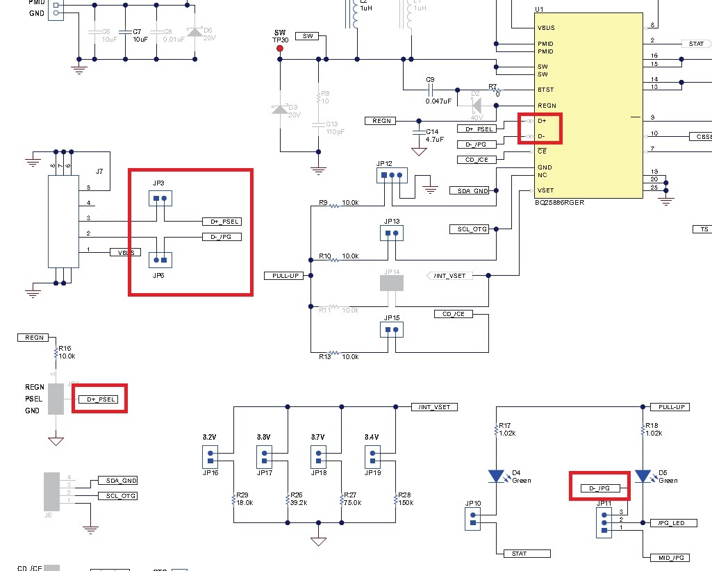

Dear Sir,
Related to BQ25886, I have tested BQ25886 EVM, and some question about drawing schematic.
Please review my schematic and let me know problem.
1. Input currnet: I want to connect 1A D+/D-. How can I connect D+/D- ?
==> Refer to Input current limit setting from D+/D- detection, input current is 1A if DIVIDER 3 choose, how can I connect D+/D- ?
2. Review my schematic, and let me know wrong point.
Thank you.
  • Sean,
    1. If you wish to force the D+/D- detection into Divider 3, you must apply 2.0V on D+ and 2.7 V on D-. I suggest you do this by having a resistor divider from a reference voltage to GND. This reference voltage can be created from an LDO tied to SYS or BAT similar to the EVM schematic.
    2. I cannot see all of your schematic from the screenshot. Please send me the complete schematic and I will take a look.
