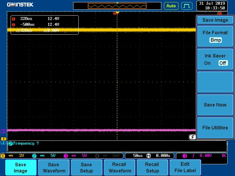

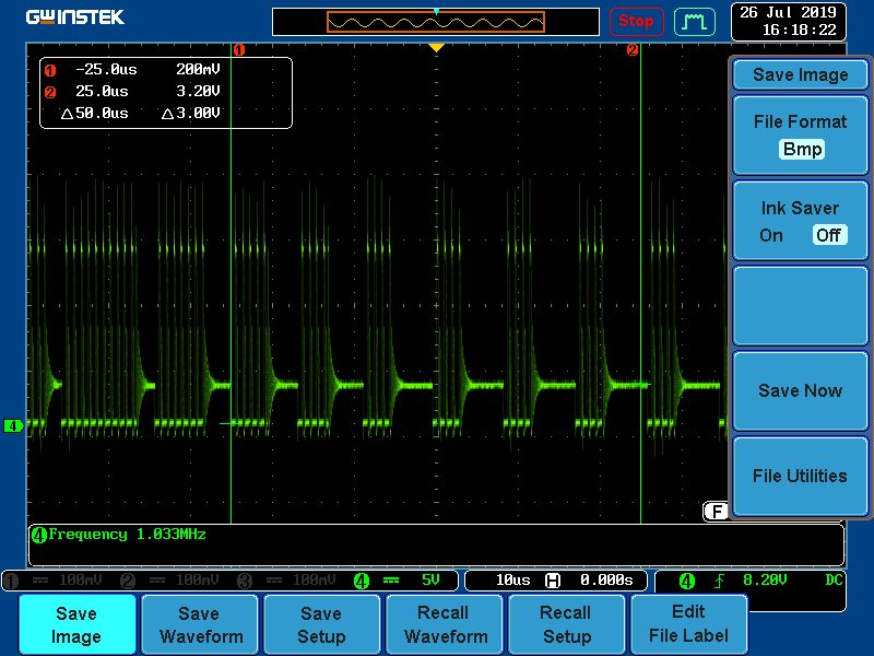

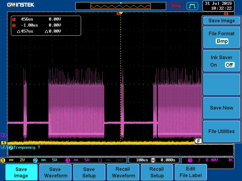

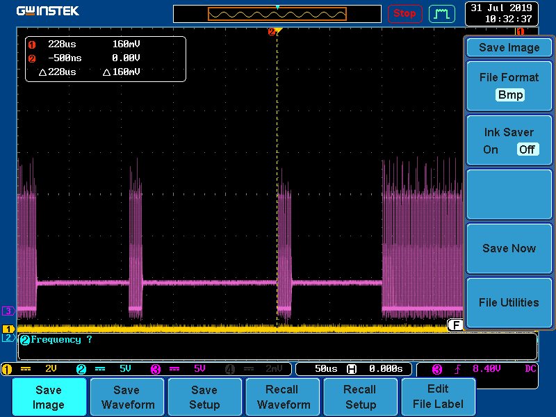

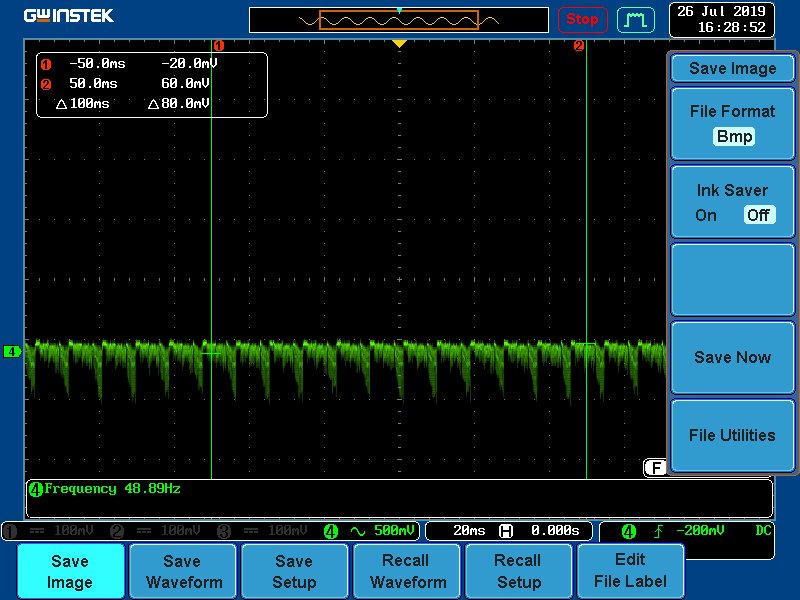

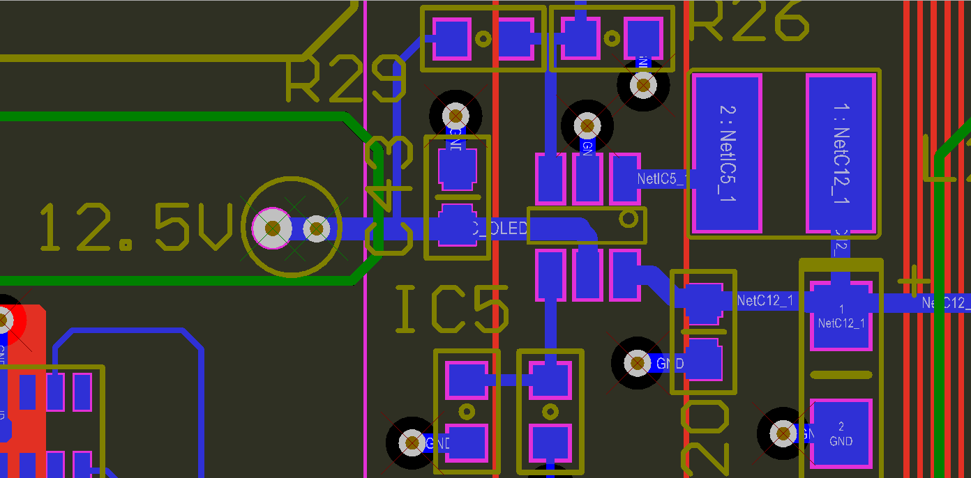

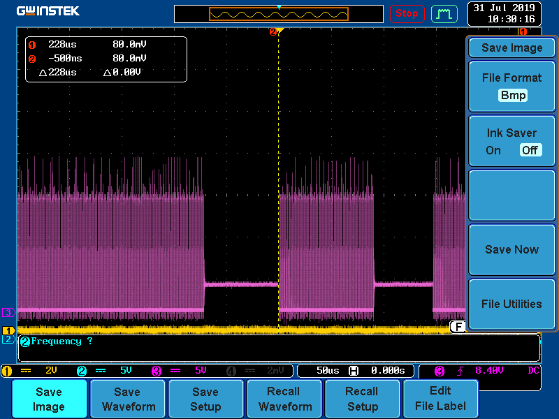

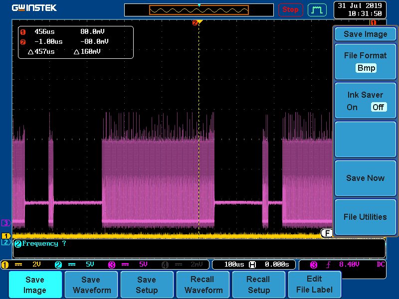

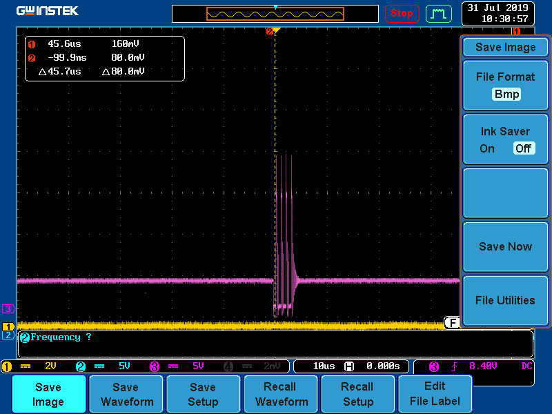

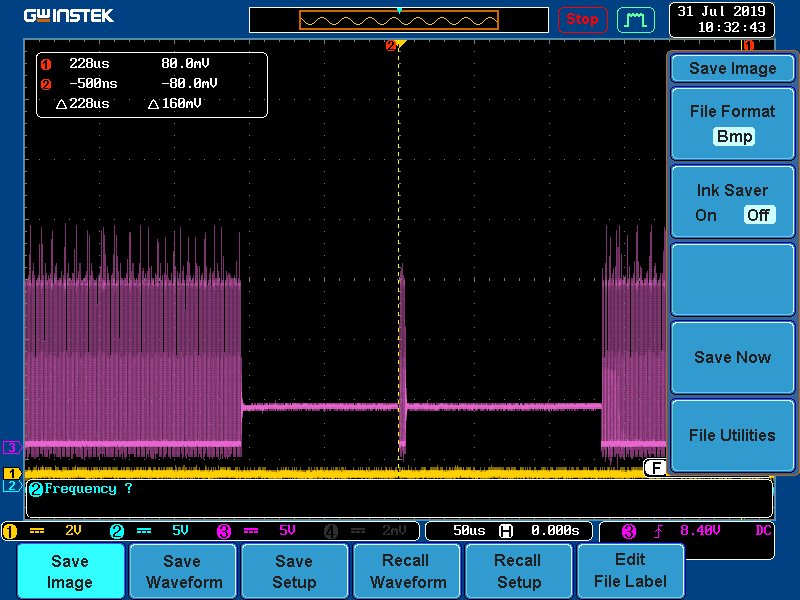

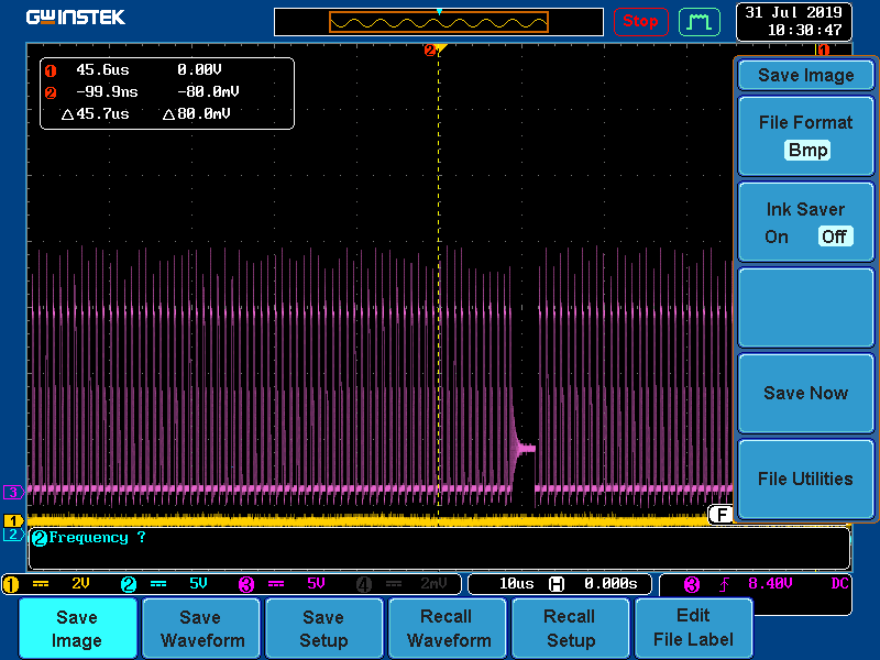

Hi, please help me about power IC TLV61046. I use TLV61046 with Vin = 2~3.5 V ( DC), Vout = 12.5V ( DC), when i add resistor load with load current about 50ma, It is running good. When i add OLED load ,Load current range from 30~ 40ma, whistles from the inductor comming out, why dose is it and what is the solution? Please help me, Thanks !
