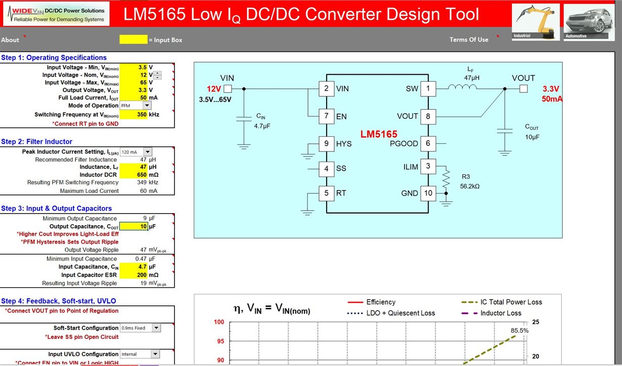

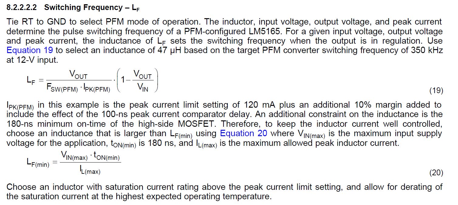

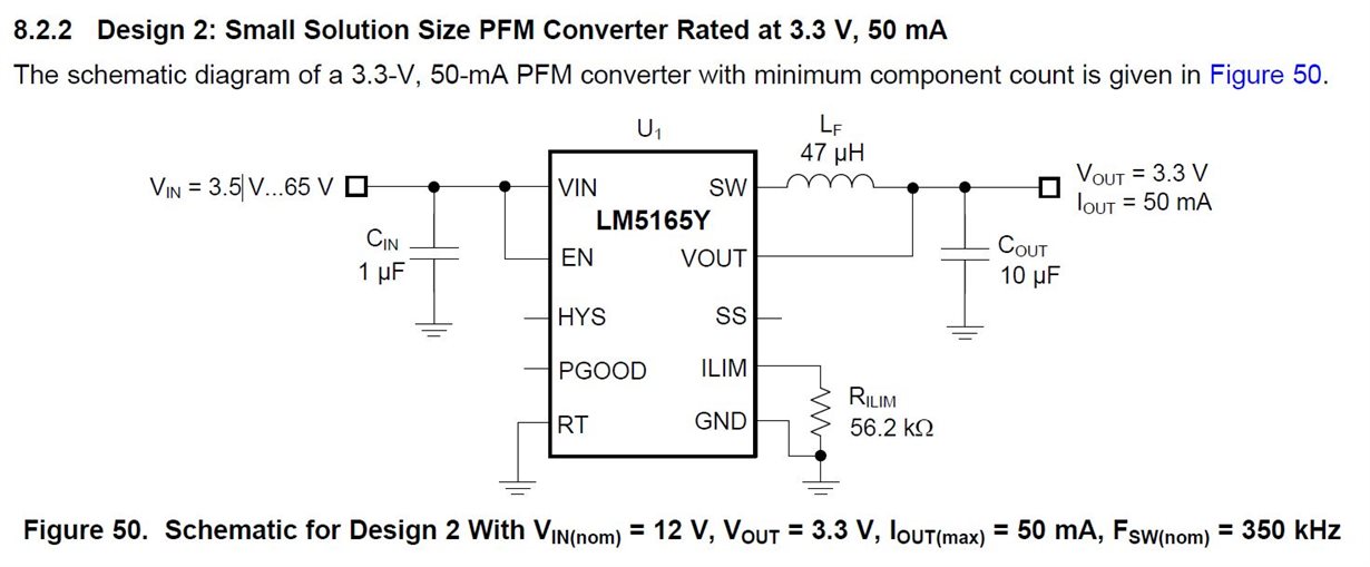

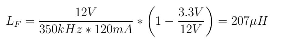

I am trying to calculate the required inductance for design 2 in the LM5165 datasheet using equation 19.
With the numbers given above, I am not calculating the same result.
The both the datasheet and the LM5165 Wide Vin Low Iq Buck Converter Quickstart Design Tool excel spreadsheet give the recommended inductance of 47 uH.
Why am I not calculating the same result?
