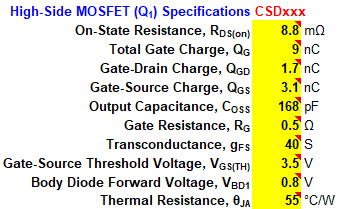

Customers have questions about FET selection.

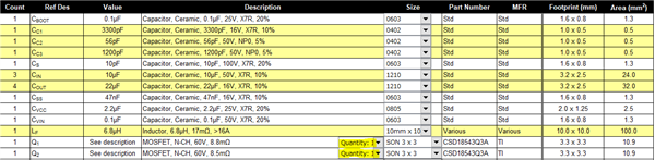

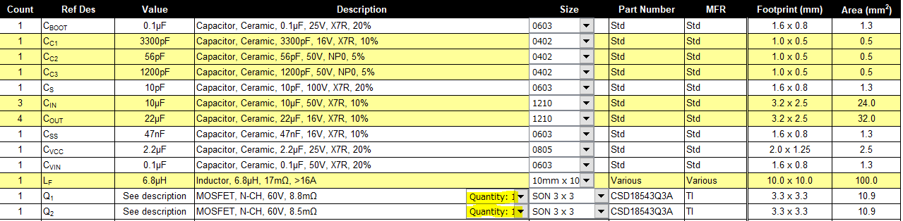

This tool can select FET quantity.
However, even if the quantity is set to 2, the FET type name remains the same.
Does it mean that CSD18543Q3A can not stand in case of one?
Could you tell me the background that can adjust the number with this tool with the same FET type name.
