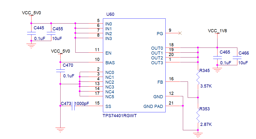

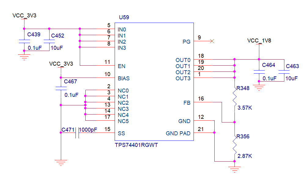

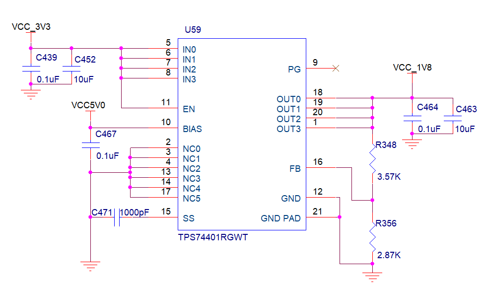

Hi TI team,
Please find the attached three different schematics designs implementation of TPS74401RGWT.
May I know which schematic will be the best way to implement and include in my design (schematic 1 or schematic 2 or schematic 3).
Also request you to review the schematics and provide your valuable feedback.
