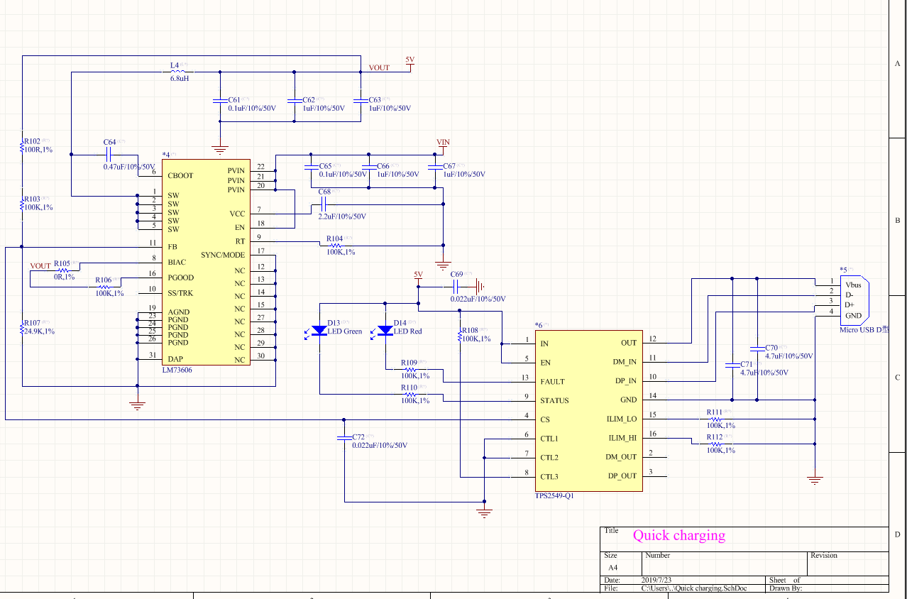

Please help check if the schematic of TPS2549-Q1 is OK? Thank you!
Hi Jeffrey,
Below comment for the tps2549 SCH:
1) The R111 and R112 value suggest choose 20K to set the current limit threshold at 2.7A.
2) The CS pin connect to the LM73606 feedback divider is not correct. The detailed parameter and connect method you can refer to the tps2549 datasheet Page 29.
