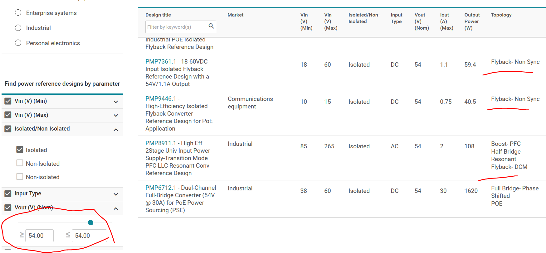

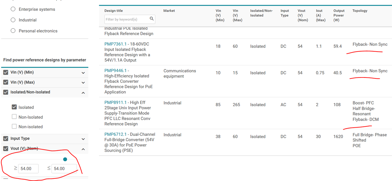

Hi Team,
From the parameters request specified, WEBENCH generated 31 different isolated designs for the 54VOUT/1A supply.
But they're all topology flyback. we need is the "Forward" topology.
Is there have a recommendation?
thanks
Kevin
Hi Kevin,
There are power Reference Design available: http://www.ti.com/power-management/reference-designs.html#search .
Selecting the Forward Topology, then sorting the resultant list by VOUT, PMP7840 is the closest to your requirements: PMP7840 -
I will see if the group that designed this Ref Design might have some recommendations for modifying to meet your requirements.
~Leonard
Hi Kevin,
Nearly all our reference designs at this power level are flyback. We do have a range of reference design for active clamp forward using UCC2897a,
But there is not an exact match to your requirement.
Peter
