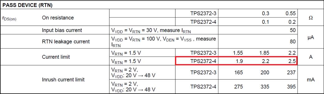

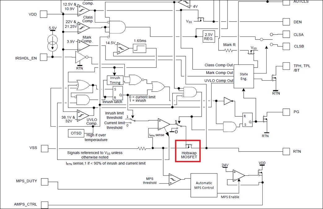

If PD load is up to 120W load, Can TPS2372 be added external MOSFET to improve overcurrent limitation?
Or how to deal with it?
BR
Kevin
  • Kevin, Suggest you point the customer to our application note entitled "Beyond BT High-Power PoE Solution using the TPS23880 and TPS2372-4."
