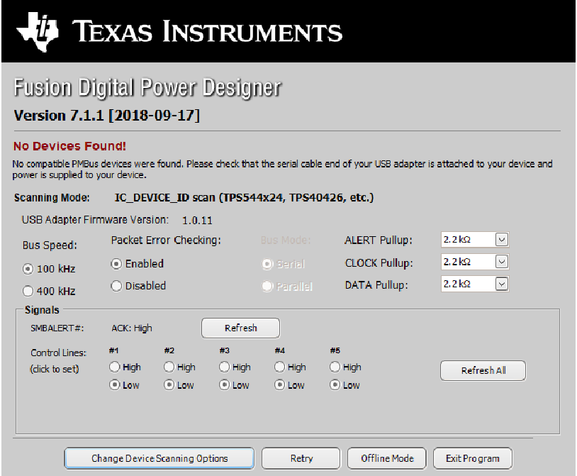

  • Hi Peter,
    I'm using USB interface Adapter connects to the laptop but The Fusion GUI doesn't recognize my adapter. Is there any recommendation?

  • Hi Peter,
    I got this message. Please see the attached
    I also see the green LED on
    Yes we got it from distributors
    - Tuan D.
  • Tuan D,
    This indicates that FUISION is seeing the dongle and it is working, but that it is not detecting a compatible device over PMBus.
    FUSION uses a scanning technique where it repeatedly reads a PMBus command from each PMBus address, looking for a recognized response to identify the part.  The TPS546C20A uses IC_DEVICE_ID to identify the part.  In the FUSION GUI "Device Scanning Options" you  should have an option to scan IC_DEVICE_ID.
    Try  "Change Device Scanning Options" and selecting IC_DEVICE_ID for the scanning option.

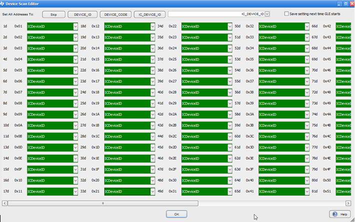

  • Hi John,
    I'm trying but i still got same problem. Please see thea attached and recommendation.
    Which one should i select?
  • Tuan,
    Try setting the first (1d) box to 4620h and then try.

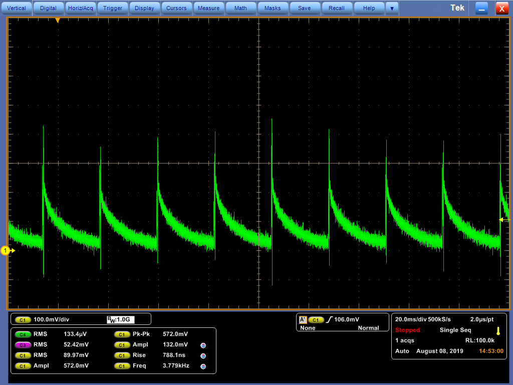

  • Hi Peter/John,
    Please see attached image for V_out 0.8V. It looks keeping reset. So how to get RESET to stable?
    - Tuan D.
  • The waveform shows the output voltage only getting up to about 300mV with each reset attempt.  That would generally indicate an over-current condition.  The ~ 20ms reset timing is also correct for an over-current condition, but the output voltage is discharging at about a 10ms time constant, which would not be indicative of an over-current unless the 300mV is below the compliance voltage of an external load.
    Is there a load connected to the board?
    What is it set to?
    Have you used an oscilloscope on the input to make sure the input voltage is not collapsing when it tries to charge the output capacitors?

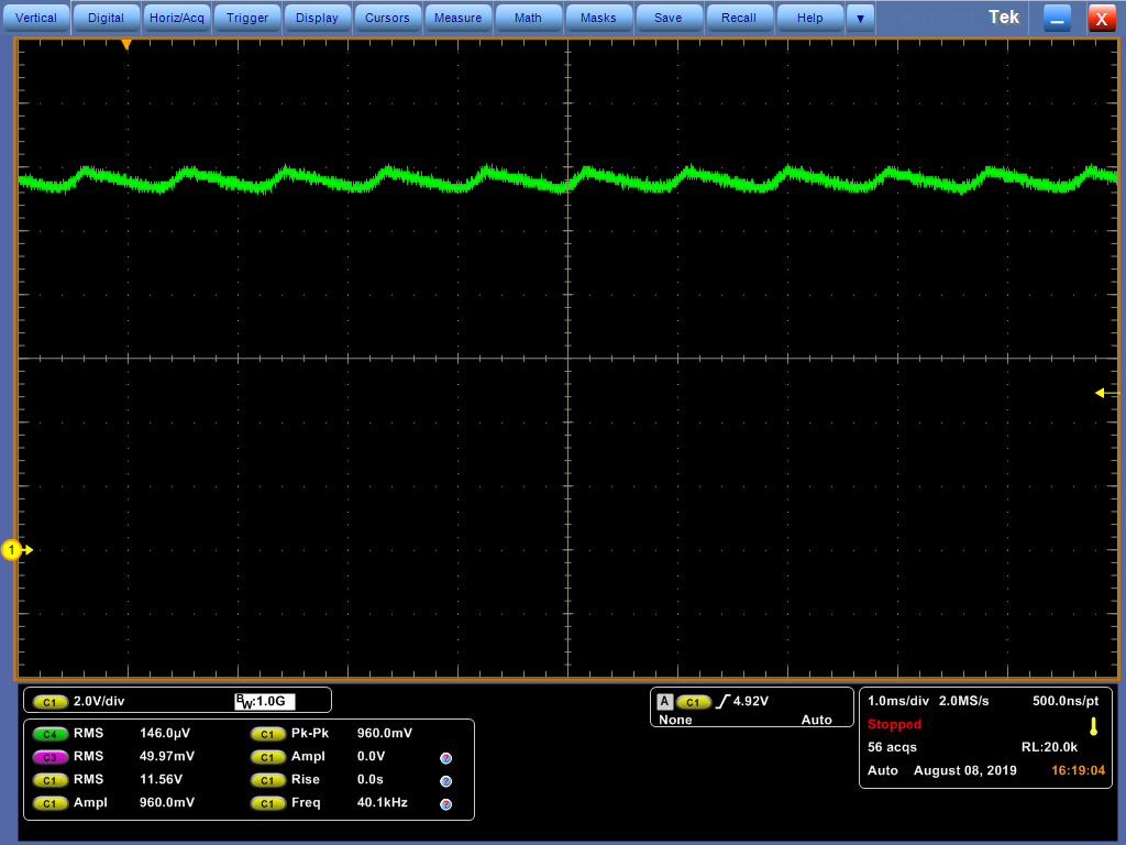

  • I'm using the part as the default setting so I don't program this part.
    Please see the input waveform. It seems 12V input is not stable, it may cause the output.
    Please advise.
  • Tuan Dang1,
    Your e-mail about the output voltage was taken at 20ms / division and shows a period of just over 1 division, this shows 1ms/division, also with a timing of 1 division, that would not be consistent with the input voltage ripple being caused by the output voltage ripple.

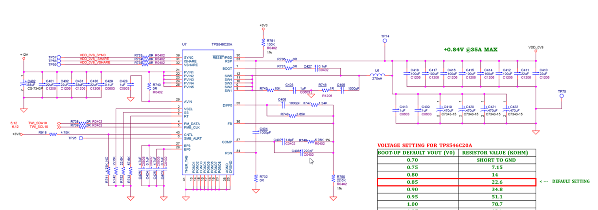

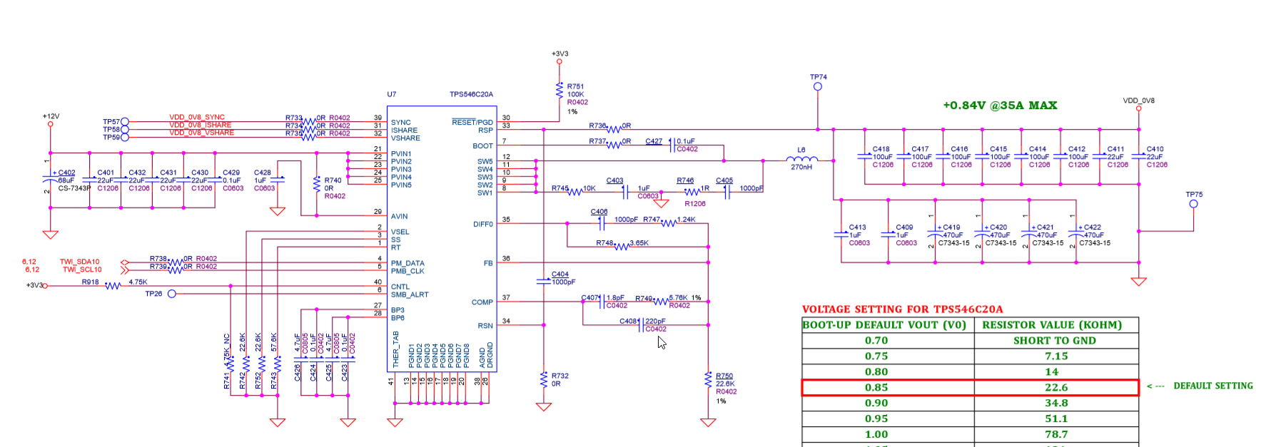

  • HI Peter,
    Please see the attached schematic.
    Please advise

  • Tuan,
    Where did the compensation values between DIFFO, FB, COMP and AGND come from?  They don't appear to be stable give the output filter you have.
    Try updating the following component values:
    1) Remove R750 (FB to AGND resistor)
    2) Change R748 (DIFFO to FB) from 3.65k to 10k Ohms
    3) Change R747 from 1.24k to 442 Ohms
    4) Change R749 from 5.76k to 3.32k Ohms
    6) Change C406 from 1000pF to 4700pF
    7) Change C407 from 1.8pF to 8200pF
    8) change C408 from 220pF to 390pF
    Based on the listed output filter and about 10mOhm per 470uF electroluytic capacitors, that should give you a bandwidth of about 40kHz with sufficient gain and phase margin for stable start-up and operation.
