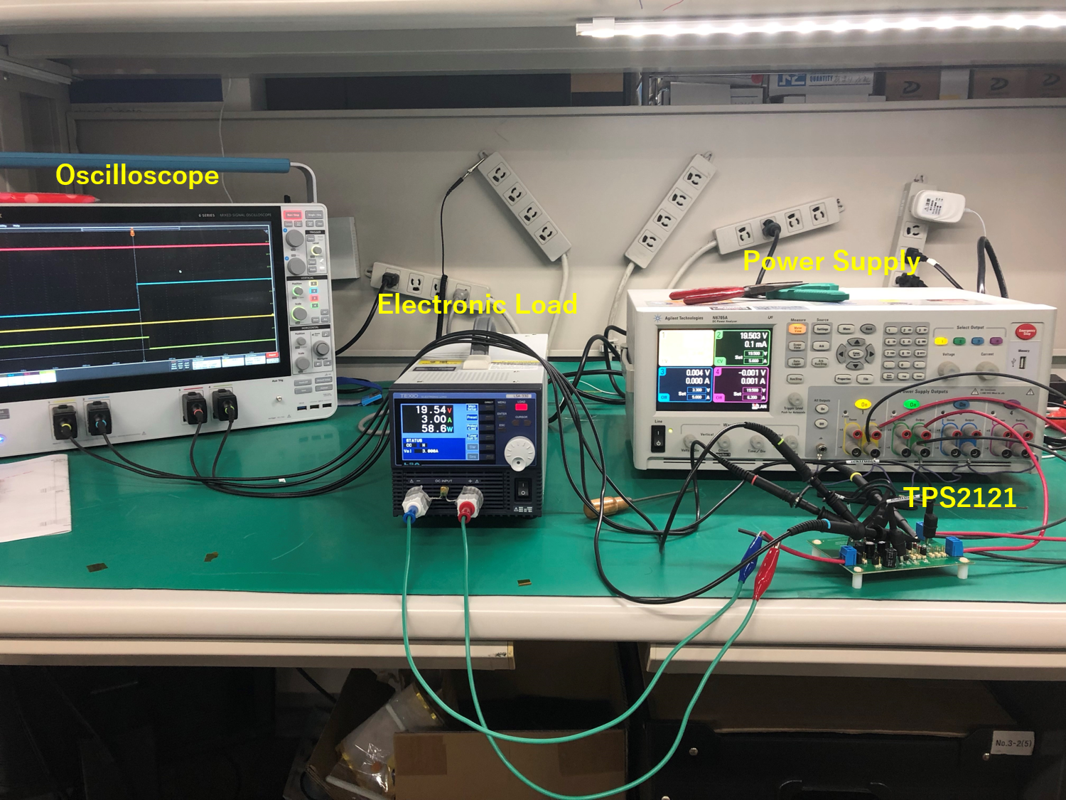

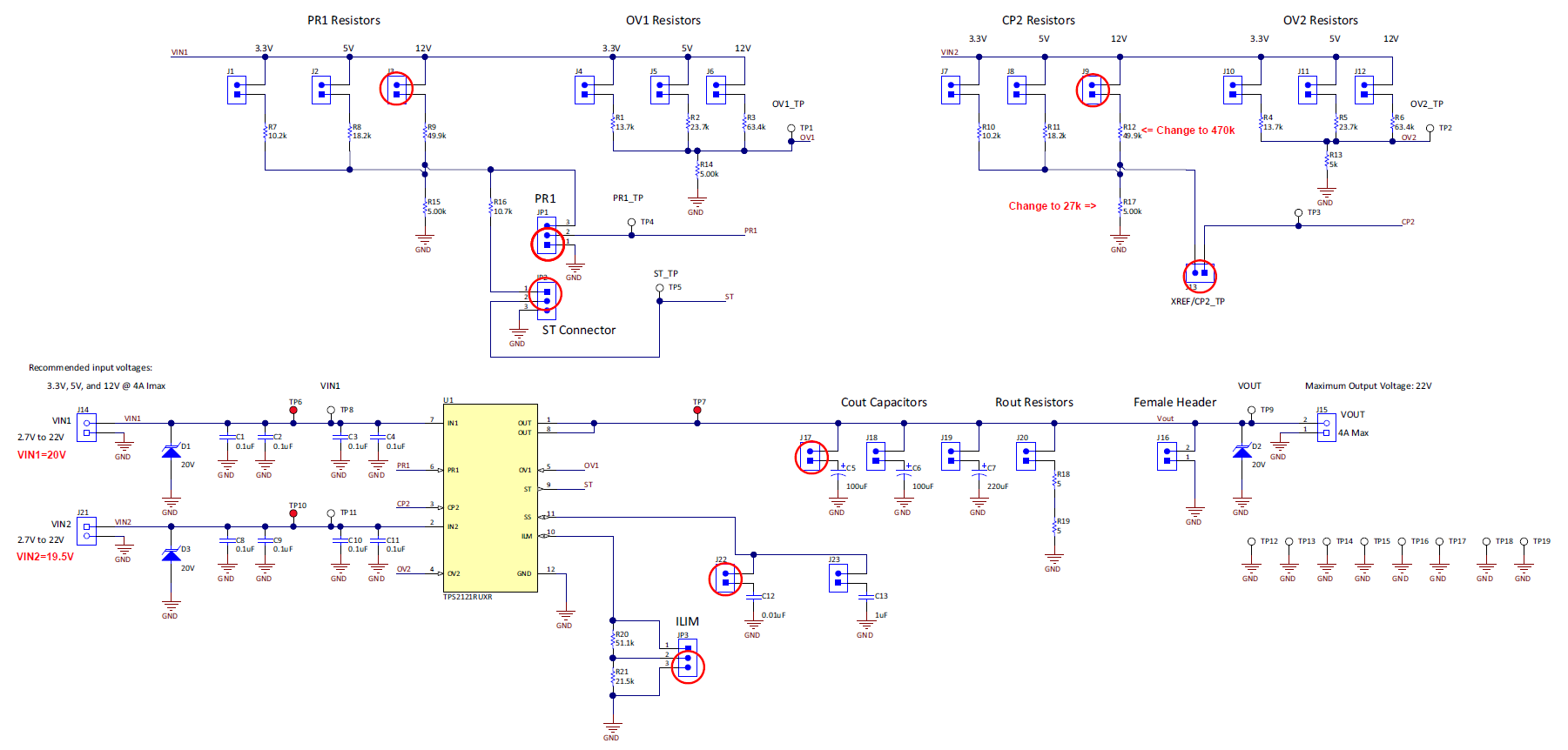

I'm checking about Input channel selection and ST pin with TPS2121EVM-023.
Fig.1 is my circuit and Fig.2 is my environment.

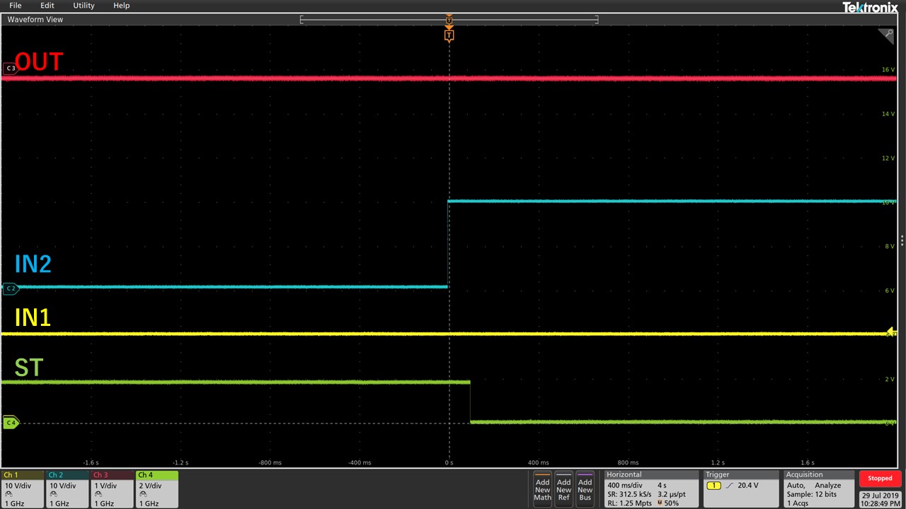

I operated that IN2 was valid after IN1 was valid.
I guessed the IN2 was selected and ST was low because CP2 was higher than PR1.
Datasheet (excerpt):
>If PR1 > CP2 then IN1 is used, and if PR1 < CP2 then IN2 is used.
>ST is pulled high when the output is Hi-Z or IN1. It is pulled low when IN2 is powering the output.
However, according to Fig.3 and Fig.4, IN1 still loaded current (3A) even though ST pin was low.
How come this situation occurred?
Fig.1 Circuit :
Fig.2 Environment:
Fig.3: Oscilloscope
Fig.4: Electronic Load

  • Hi Kensho,
    I talked to a few designers about your issue and my inclinations were confirmed. The voltage on the CP2 pin is not sufficient to flip channels.
    ST indicates which channel is enabled in steady state after soft start operation is done. When both  PR1<VREF and CP2<VREF, both channels are enabled when VIN1 and VIN2 are close to each other( within +/-600mV of each other) and the highest of the two(VIN1 in this case) is passed to VOUT using an ideal diode operation. The system will stay in ideal diode mode passing the highest to VOUT until VIN2>=VIN1. As a result, VIN1 is passed to VOUT even though both channels are enabled. ST is going low because both channels are enabled.

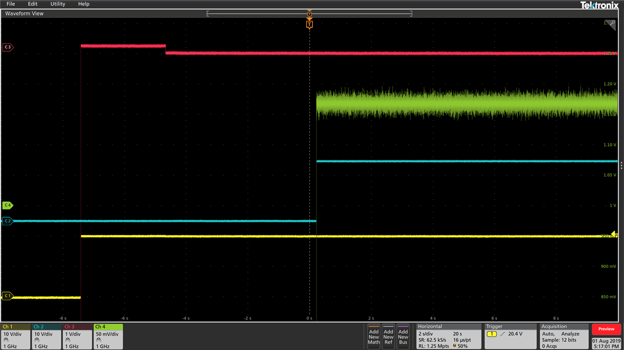

    Thank you for your answer. As you told me, CP2 was around 1.06V.
    However, it still seems that IN1 is selected even though CP2 is higher than 1.1V.
    I changed R17 from 27k to 30k and keep 470k at R10.
    ( CP2 = 19.5V * 30kohm / (30kohm + 470kohm) = 1.17V )
    As shown in Fig.1, IN1 is selected even though CP2 is higher than 1.1V.
    Do you have any other suggestion?
    Fig.1:
    Red:Output, Yellow:IN1, Blue:IN2, Green:CP2
    Kensho
  • Hi Kensho,
    In your output waveform, there is a voltage drop soon after turn on? Can you probe ST and make sure that it is not flipping channels here? Also, is there any change on the power supply from before?

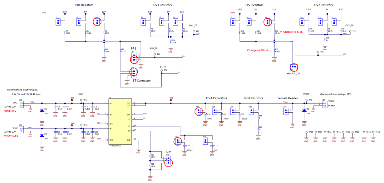

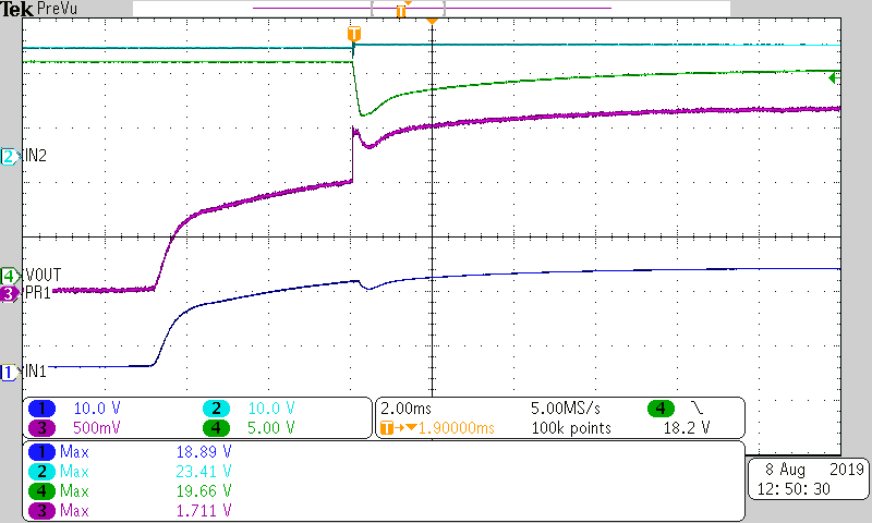

    I redesigned my circuit  on http://e2e.ti.com/support/power-management/f/196/t/827475. Please review my circuit again.

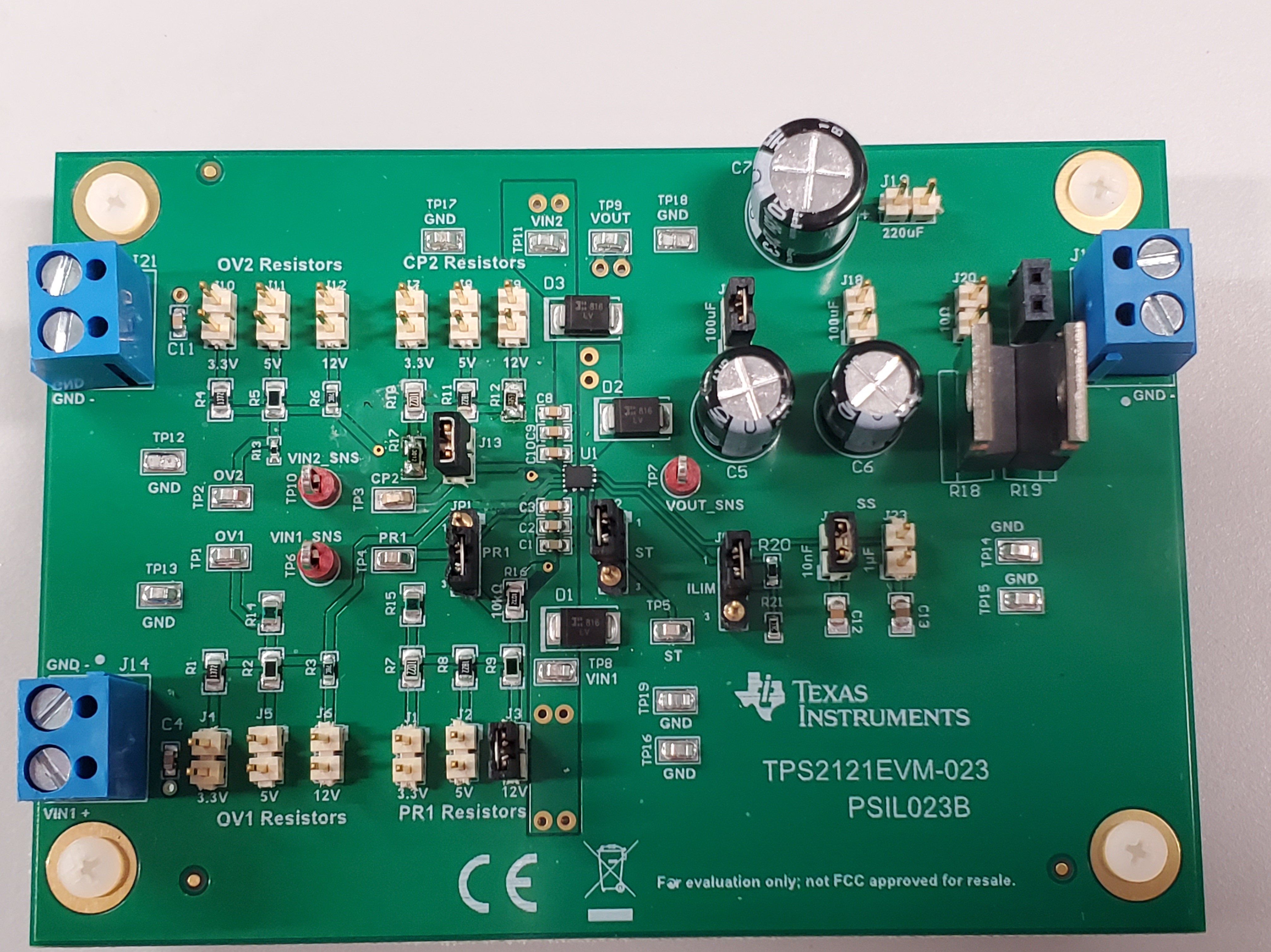

    Also, I checked the logic with EVM following your advice. However it still seems that IN2 is selected in the following case you tested.
    In this mode of operation, when IN2 is present but IN1 is invalid, the device uses VREF mode to send IN2 to the output. As soon as IN1 is connected, and the voltage on PR1 is goes higher than Vref, the device prioritizes IN1 over IN2. As long as PR1 is greater than Vref(in the case that CP2 is pulled low), the device will prioritize IN1.
    I attached my EVM and signals.
    Fig2:
    Yellow: IN1 (+19.5V)  Blue:IN2 (+20V),  Red: Output  Green: PR1
    Kensho

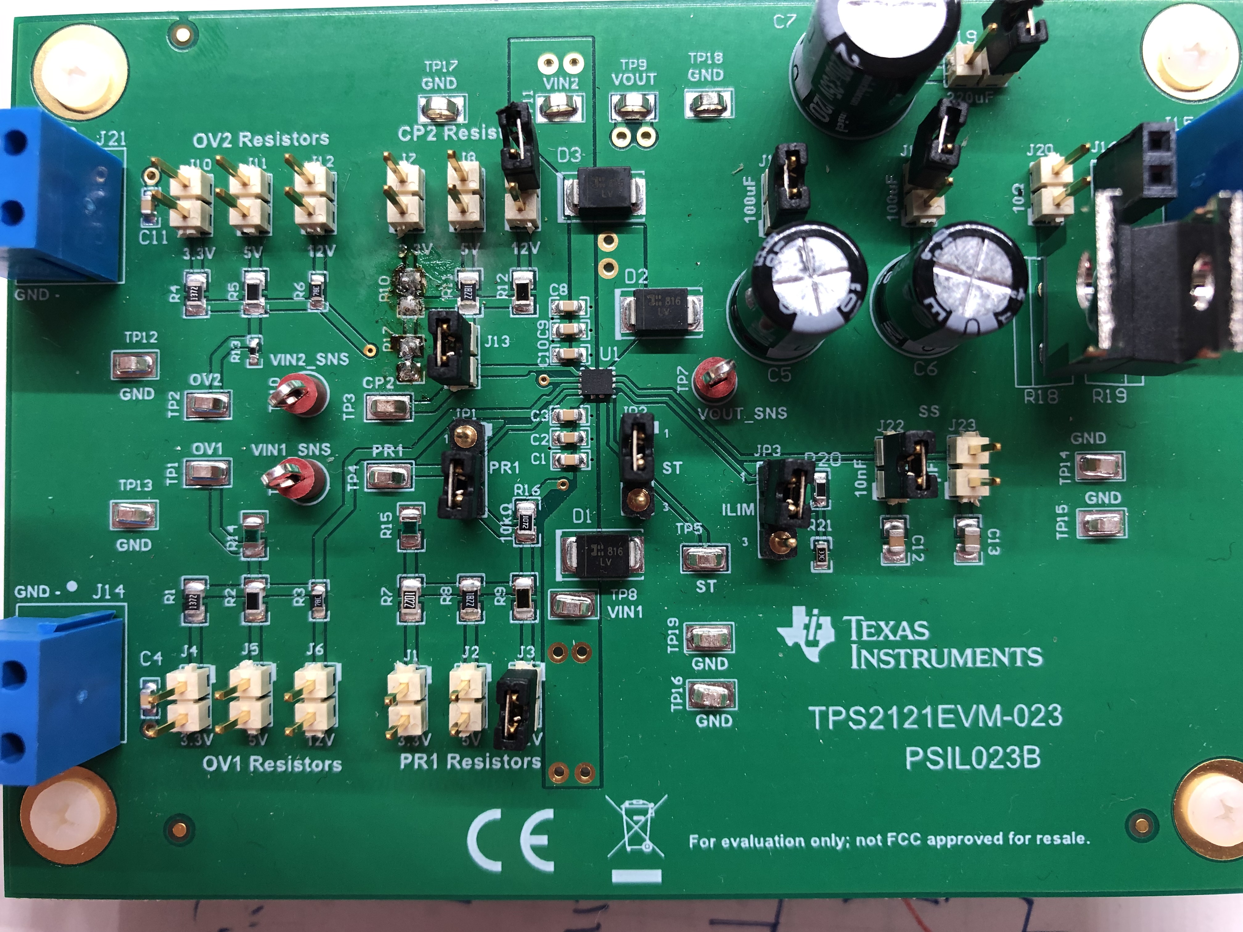

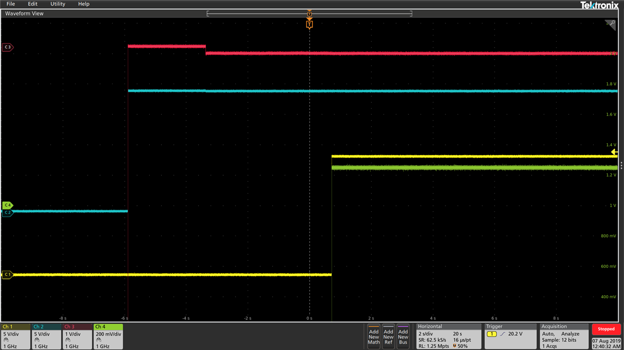

  • Hi Kensho,
    Here is a picture of my EVM:
    Here is my scopeshot:
    As you can see, I have successfully muxed the power rails in this configuration. Do note that the PR1 voltage dividers are not set correctly for 19.5V and 20V operation so the voltage on PR1 rises above Vref earlier causing the mux to happen earlier. Also note that due to the non-idealities in my setup, the voltage seen on the board is a little lower than what is output from both supplies. I used a power resistor for this application and the load current I ran this at was at 2.7A. This was the closest I could get to your 3A current draw due to the precision of my power resistor.
    To reiterate IN1=19.5V and IN2=20V. CP2 is pulled down through R17. PR1 uses the 12V voltage divider network on the board.
    If you have not changed any resistors on the PR1 voltage divider network, this is the exact operation you should see.
