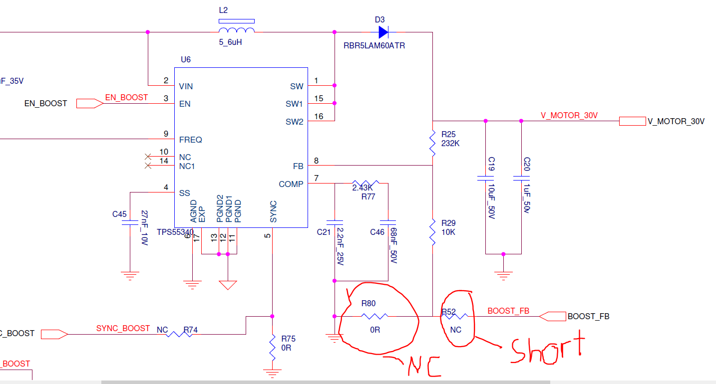

hi,
bellow please find my connection to the FB pin, the BOOST_FB is connected to a DAC on my microcontroller.
is there a way to control the output voltage of the boost by using this DAC or other SW controlled part? that is, without changing the connected resistors?
Thanks for your help
Hen
