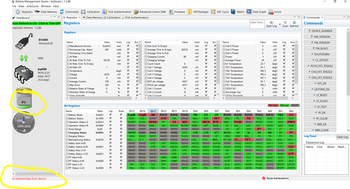

I connected the bq4050 with EV2400.But the screen  always display the : No acknowledge from device.From the picture below we could see :The BQstudio has detected the bq4050.Why No acknowledge from device ?

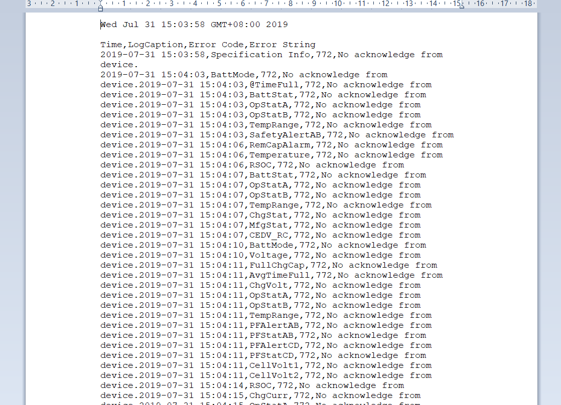

In addition to this,I start to log it with 1A discharge current.Then BQstudio gengerate a log.err log like the picture below?why ?

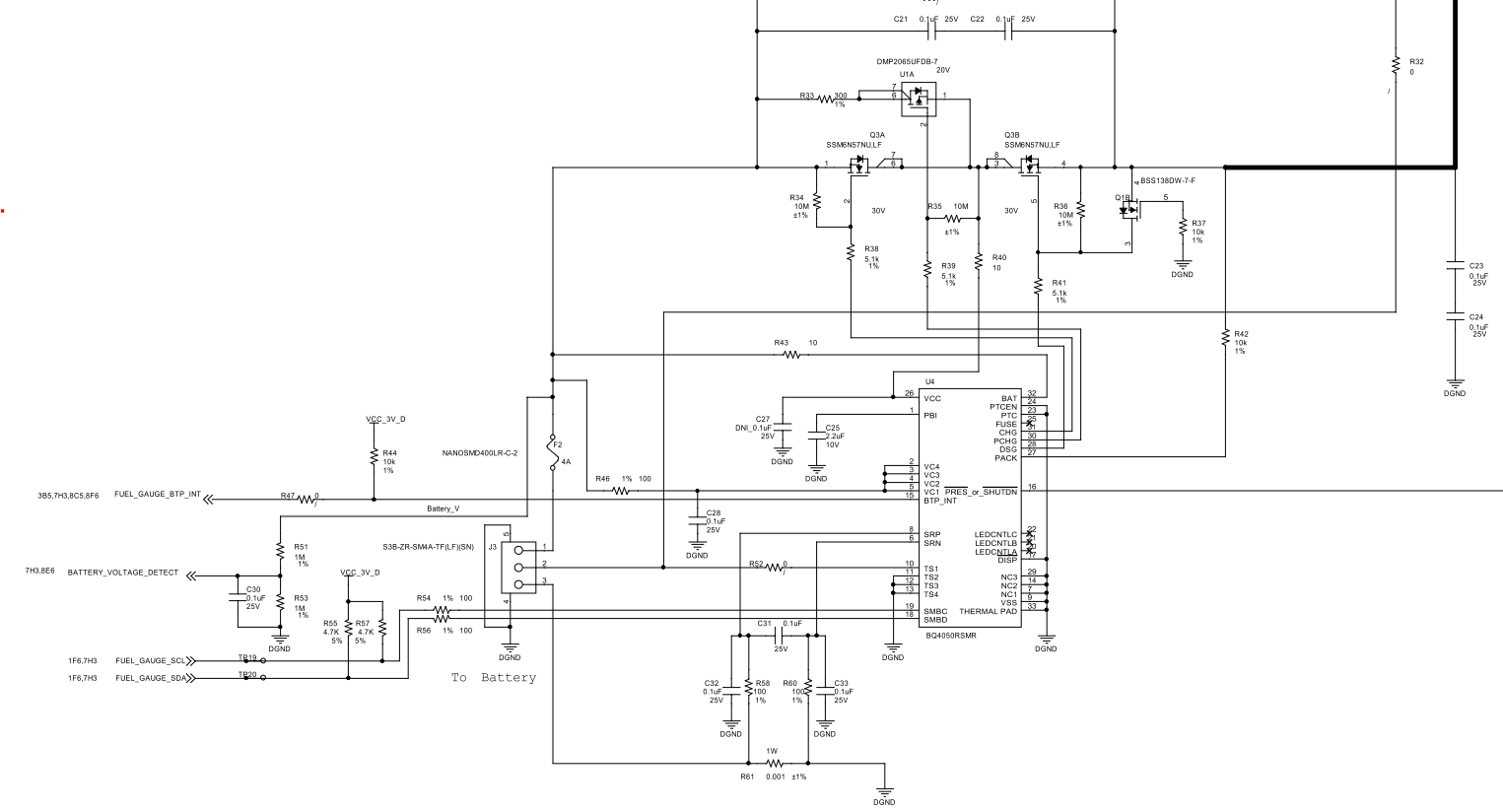

please review my schematic of bq4050 ,Is there any error????
  • You have to adjust your cell config correctly to prevent the gauge from shutting down. Please set CC1, CC0 to 01, this will change your config to a 1s config like your schematic shows.

    So My question is:
    1:Setting CC1, CC0 to 01 will change the Cell Count to 2cell.What is it for?
    2:Another question ,What do you mean by that "this will change your config to a 1s config like your schematic shows"??
  • 1. Ah, sorry. That was a typo, I meant 00 instead of 01. CC1, CC0 set to 00 is 1 cell.
    2. Your schematic shows a 1s config, I was thinking your config in df was not set to 1s and that was causing your issues.
